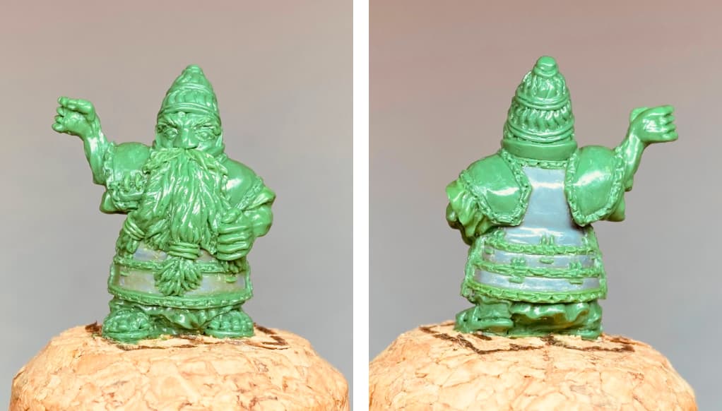

Work on the Artisan’s contest dwarf has continued. I decided to redo the hastily applied lacing on the armour and added arms, shoulder plates and a beard. @Admiral asked me to do a tutorial on how to do the armour which I will do in the future but not on this model as I had to figure out by myself how to do it. The whole project so far was a steep but invaluable learning experience as I was consciously doing multiple sculpting steps at once instead of ‘quick-saving’ all the time. This not only accelerated the whole thing but also made it easier in some places to get the desired results (the helmet tutorial mentioned above truly was a sculpting epiphany for me): doing the lacing together with the panoply armour plates (as on the shoulders) was a lot less frustrating than applying them to the already cured plates.

If you remember, this guy was my unfinished contribution to the Artisan’s contest in early 2022. I tend to have regular hobby breaks every few months, so I left him 95% done in my cabinet since I last posted. Very eager to start a new sculpting project, so I added some hands, finished the lacing and made sure that there are no problematic undercuts. The missing cavity in the raised hand is intentional to make him cast better as the hand will be drilled out anyway. I plan to cast up a whole regiment of them when the outside temperatures are warmer again and run them as heavy pikemen in the DoW list (and just have to accept that their stats are human). My hope is that if I add custom plumes to all of them they won’t look too uniform although phalangites are not very demanding in that respect.
Speaking of casting. I did cast up another 100 or so miniatures last summer (the Dwarf and the Hobgoblin sculpt from above) and I have to say I’m impressed about the mould material quality. I probably did around a hundred casts with the dwarf mould in total and it still holds up! The Hobgoblin was more tricky: The two legs + a small casting channel in between were not enough to allow enough mass to flow in, so I had a lot of rejects due to soft details. Next time, I will first try to increase the channel size. But nonetheless, a few of them are good enough that I can work with them.
For the regular chaos dwarfs, I’m a bit torn between sculpting the arms myself (still fed up with arm anatomy – I don’t know why but doing them in a multi-part fashion is 100x more difficult to get the scale right compared to just sculpting them directly onto the miniature) or using arms from various kits. However, there is distinct lack of unarmoured dwarf arms without long sleeves out there. @Admiral kindly pointed out the Avatars of War slayers although they are a tad too muscular for my likings.
I love that sculpt! Both in design and execution. All the best for the casting project. I’m already looking forward to seeing a regiment of them painted up :hatoff: are you planning to add a cowhide shield, perhaps even a figure-of-eight body shield?
@Antenor Cheers mate, and yes, absolutely! My plan is to go for a small cowhide dipylon shield. I love the figure-of-eight shield but haven’t figured out a good way to scratch-build them from aluminium sheeting and putty. Styrene would unfortunately get obliterated during vulcanization. Maybe I could source them from third-party models or STLs…
Fantastic work on the spearman! Love the sandals and beard, and the lacing is cherry on top.
Interesting casting thoughts. Complicated, convex shields as loose pieces are damn difficult to make by hand. The easiest way to handsculpt them would be to cheat and make them an integral part of the cast model, rather than multipart. Third party producers and STLs might be your friends here.
Yes, multipart is always a lot more tricky. One way to make it easier could be to ask @MichaelX for printed arms in use for a certain something else. Or take the odd route of sculpting an arm on a full miniature, and then clipping it off and repairing. Food for thought.
Thank you, an excellent idea with the integral shield but probably too late to add at this stage (at least for this sculpt).
I thought about this after posting here. Very likely that I’m going to attempt something along these lines.
