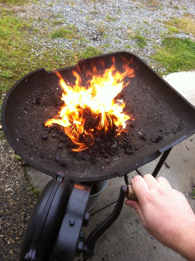

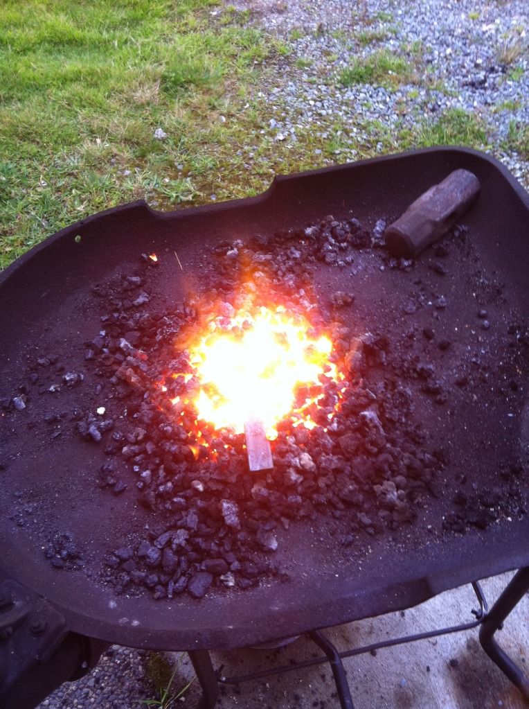

I’ll start off with a few poorly taken pictures:  First, my forge:
When I first light it
And after fifteen minutes of coaxing the coal to maximum hottness

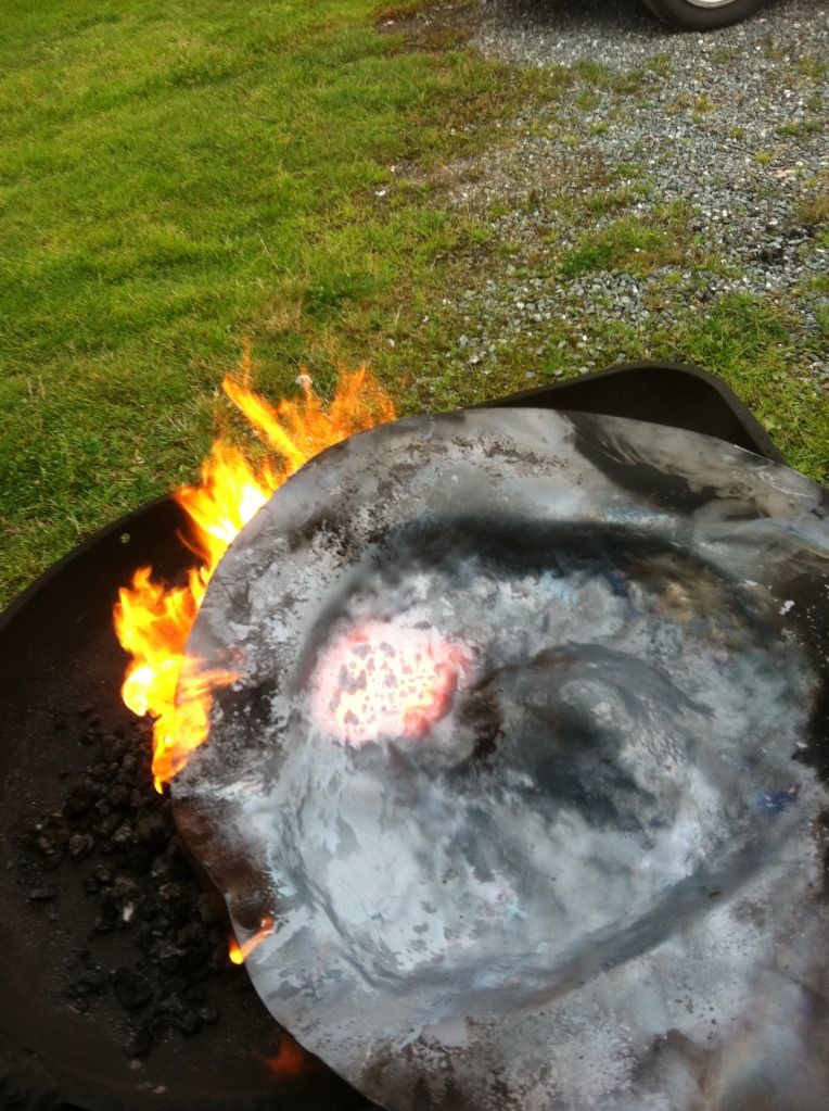

This is a test bascinet I was trying to raise (see if you can spot where I went wrong!)

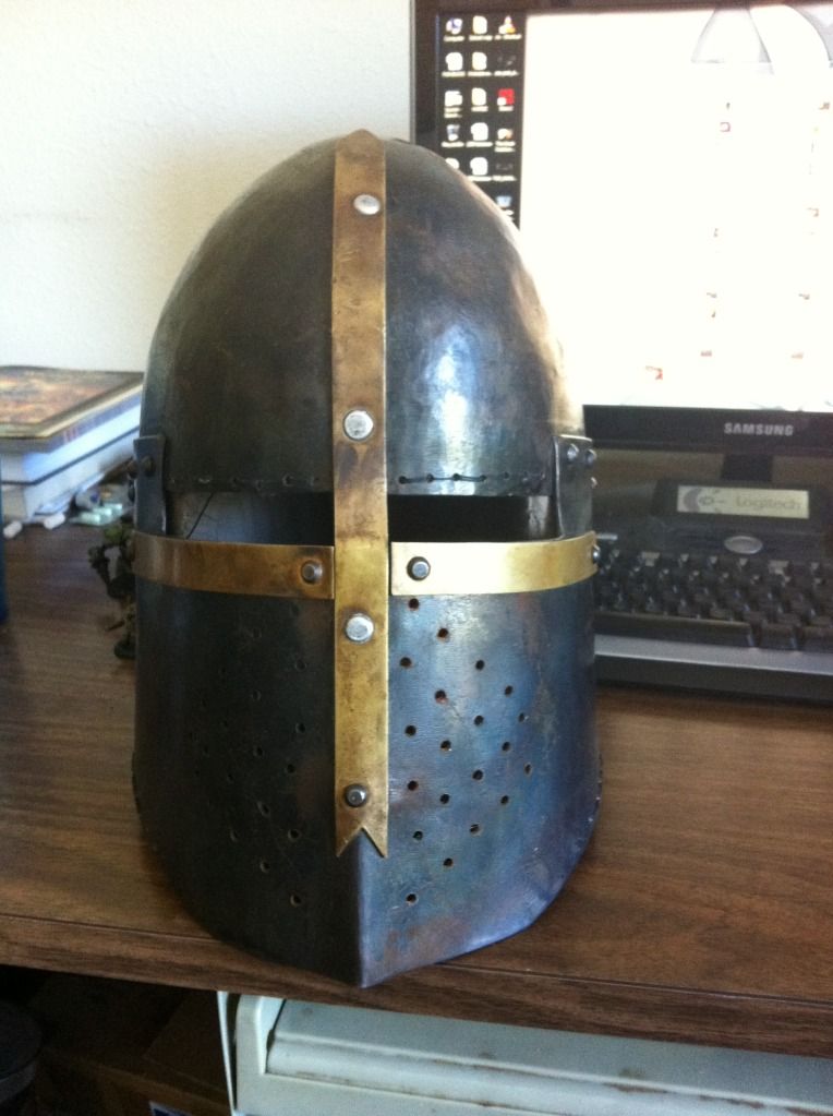

And, unfortunately since the rest of my helms/harnesses are out at my shop, this is the only finished piece (my first sugarloaf helm) that I can show right now:

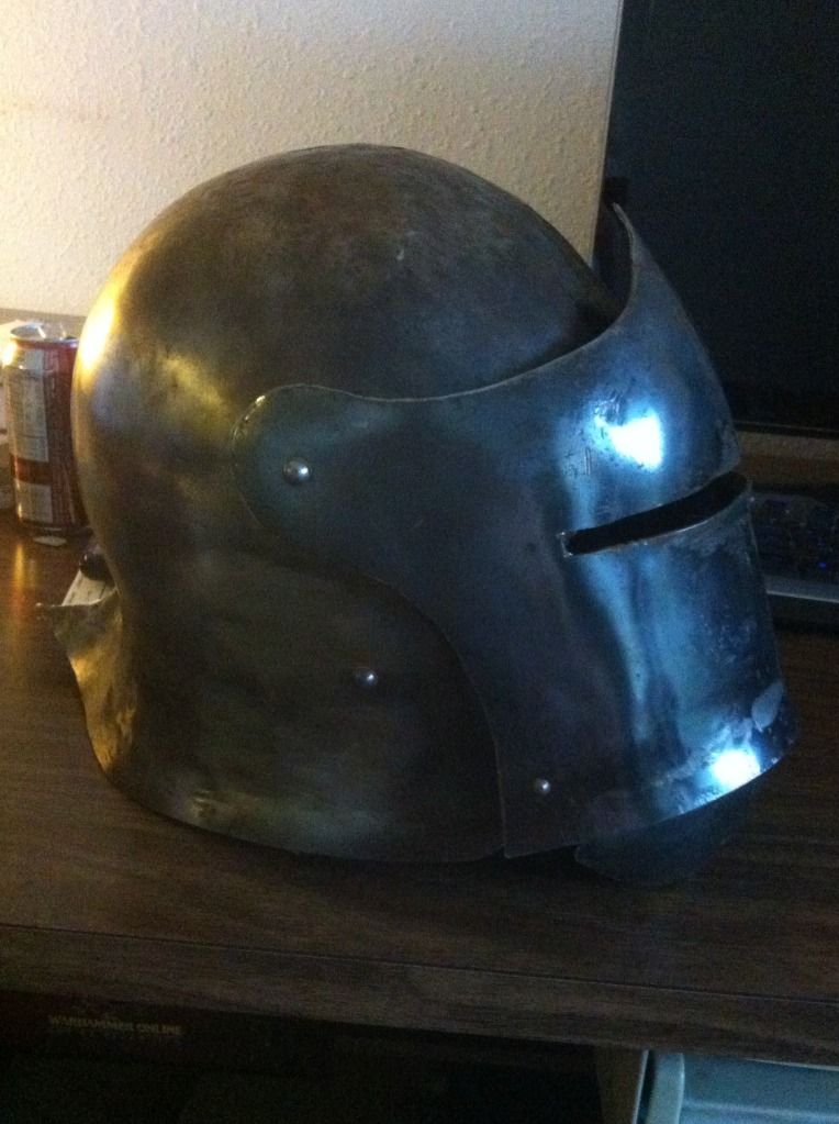

Sallet that a friend of mine made (not a true Sallet, technically, since the helmet is designed for use without a bevor)

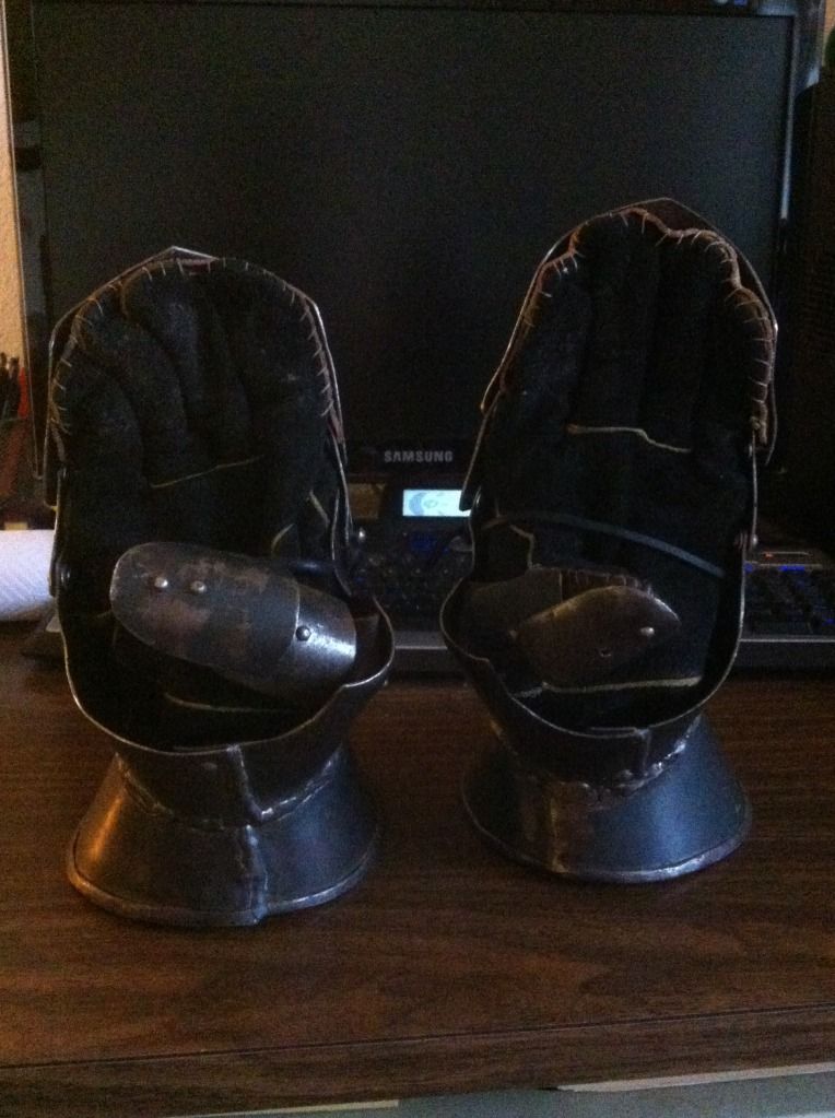

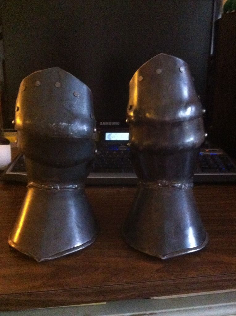

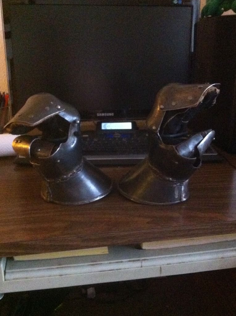

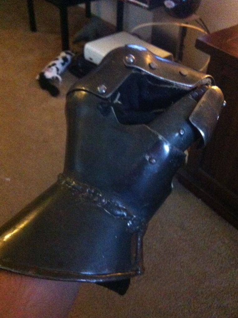

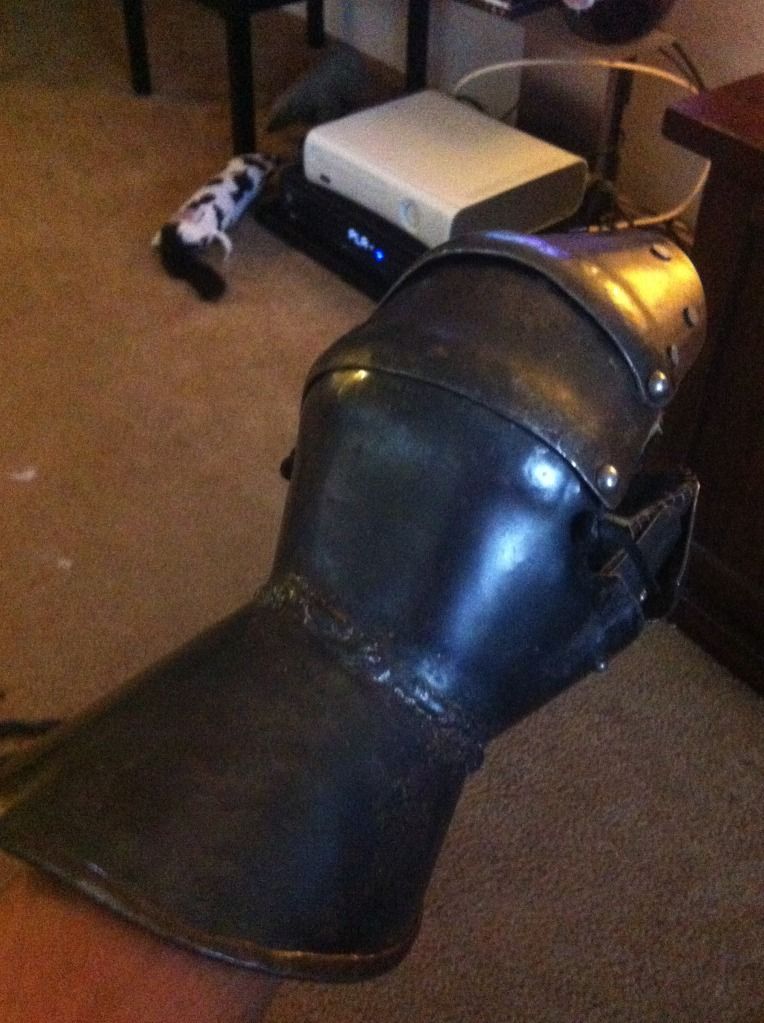

Pictures of my shell gauntlets (not finished yet, pay no attention to the hideous weld lines!)

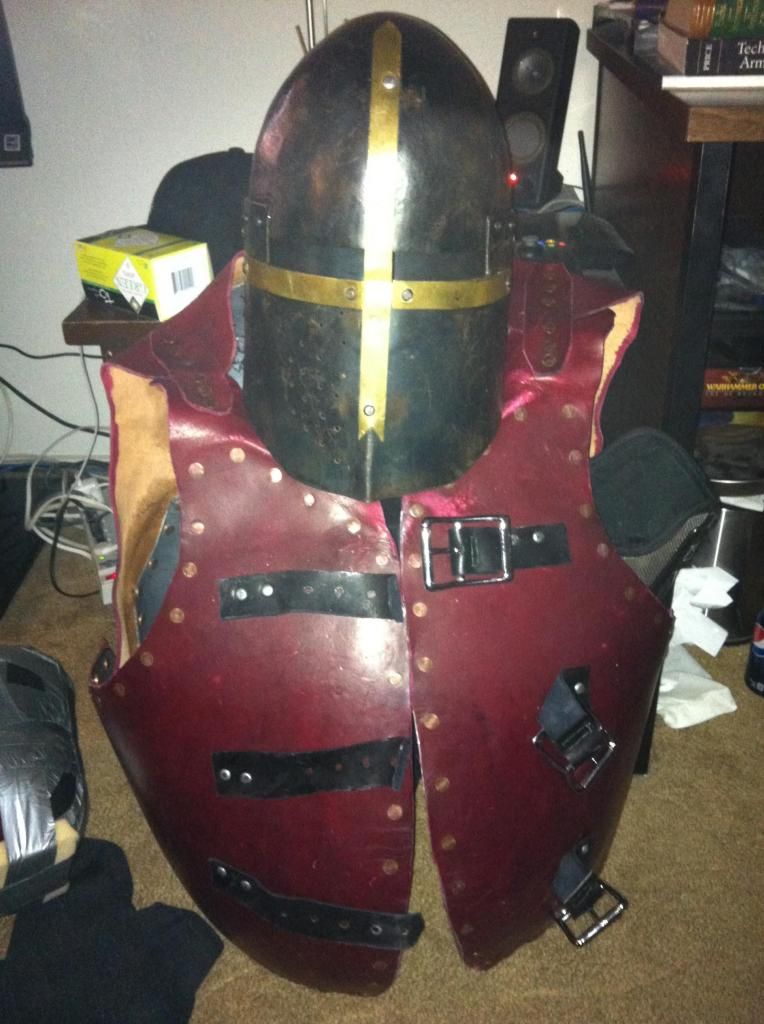

Lastly, I wasn’t going to show this one, because it’s a hideous picture, but this is something I was working on early last year.  It’s called a Corazina, and is shaped plates of steel attached to a dyed leather fronting.  I promise, it looks far better in person, and I’ll endeavor to get some snapshots of it sometimes soonish.
