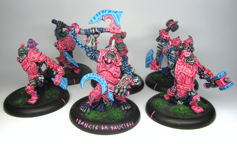

Now before you guys are ready to boot my out for painting a pink chaos lord, I must mention that it is for a charity event that will raise money for breast cancer.
Thanks for being patient with my guys. I want to get an extreme highlight color that will be crazy bright, and have a sort of metallic shimmer. I want something that pops like this pink, which is exactly what I have in mind.
The picture is not the best, but you can see how I used the color to highlight the plate on his knee and his right foot. I feel like it worked well, but like said, I could only paint in 30-45 second bursts.
This link is to a picture that is truer to the color.
http://www.google.com/imgres?imgurl=http://farm3.static.flickr.com/2519/4103782553_1bb9ff1c36.jpg&imgrefurl=http://www.flickr.com/photos/30367239%40N06/galleries/72157624440234712&usg=___wXka_4qQPo07chcVxph3YrorG8=&h=482&w=465&sz=76&hl=en&start=0&zoom=0&tbnid=pC4ptR-T62t4YM:&tbnh=129&tbnw=124&ei=vO-HTfaoN5KjtgfeqKyEDg&prev=/images%3Fq%3Dsally%2Bhansen%2Btwisted%2Bpink%26um%3D1%26hl%3Den%26client%3Dfirefox-a%26hs%3DP9%26sa%3DN%26rls%3Dorg.mozilla:en-US:official%26biw%3D960%26bih%3D596%26tbs%3Disch:1&um=1&itbs=1&iact=rc&dur=650&oei=tO-HTY6tBsTagQfZkLHVDQ&page=1&ndsp=14&ved=1t:429,r:1,s:0&tx=74&ty=61
G.2:
There is nothing wrong with painting pink minis. I am sure you could replicate that colour.
suggestion 1:
Squid pink Acrylic paint - Vallejo Game Color (# 72013)
mixed with some
Vallejo metallic medium
or
suggestion 2:
Shocking Pink by Coat d’arms 144
mixed with some
Metallic medium
Is this the sort of thing that you are trying to achieve.
Note 1: this is not my work, I am just “borrowing” the image for this thread.
Note 2: Type in “pink” over at Cool Mini or Not, and you will get a lot of images, and hopefully some hints as to painting with pink.
Glimpse the Void:
You could be be on to something with the metallic medium. I am looking for a very intense, and shiny color for some extreme line high lights on the armor plating.
I think I’m going to try thinning down the entire bottle with acetone, perhaps it will keep it’s consistency and be easy to work with if I don’t pull it out. If this fails, it will be nice to have something else I can try.
G.2:
Glimpse the Void
I thought that is where you were going, that is why I posted the above image. The highlights are more white, but they are extreme.
Keep us updated with your progress. I am keen see how you go, and what you come up with.
