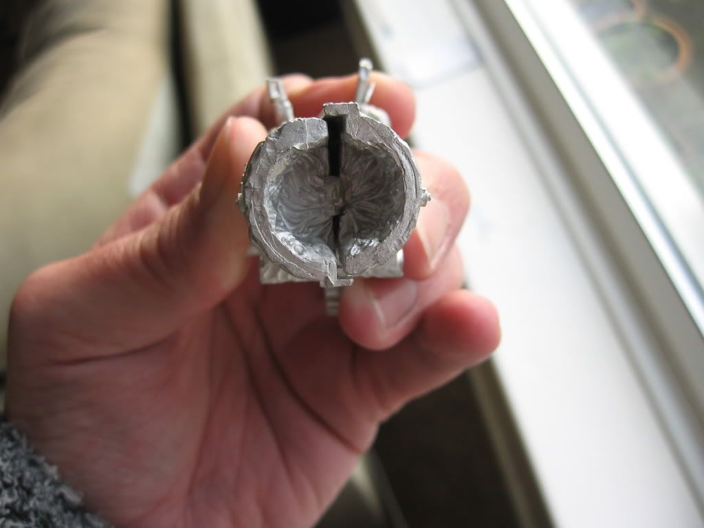

All the talk of the finecast Hellcannons gave me an idea. I (after one was given to me as a gift) have 2 metal versions so I thought that if I heat one to 2/3 of the melting temperature (the rough forging temperature for any metal) then I should in theory be able to bend them to shape without too much difficulty.
A weekend project I think

Vogon:
Thank you all for your comments and thoughts for my safety.
I think that people have got the wrong idea about me using the word soak.
The idea is to place it in a small heat treatment furnace at work at a temperature of about 120°C and leave it for about half an hour. This is called a soak time (nothing to do with getting wet) and will ensure that the whole piece is an even temperature throughout the whole thickness (ruling section). The furnace controls to plus or minus 1°C so even if I were to leave it all day it would not get above 121°C and therefore will not melt.
I will then use a pair of insulated furnace gloves (safe to a working temperature of 600°C) to lift the pieces out and attempt to bend both pieces straight.
Trust me I’m a metallurgist
Cheers
Vogon

Vogon:
Success!
140°C (about 280°F) for 30 minutes and the pieces were soft enough to bend easily. There are still a few bits that will need to be filled with GS but on the whole I’m happy with the result
Before
After
I’m sure that the average household oven will be able to cope with these temperatures and a decent set of oven (or even decent gardening) gloves will be more than adequate to reproduce this effect
Cheers
Vogon
