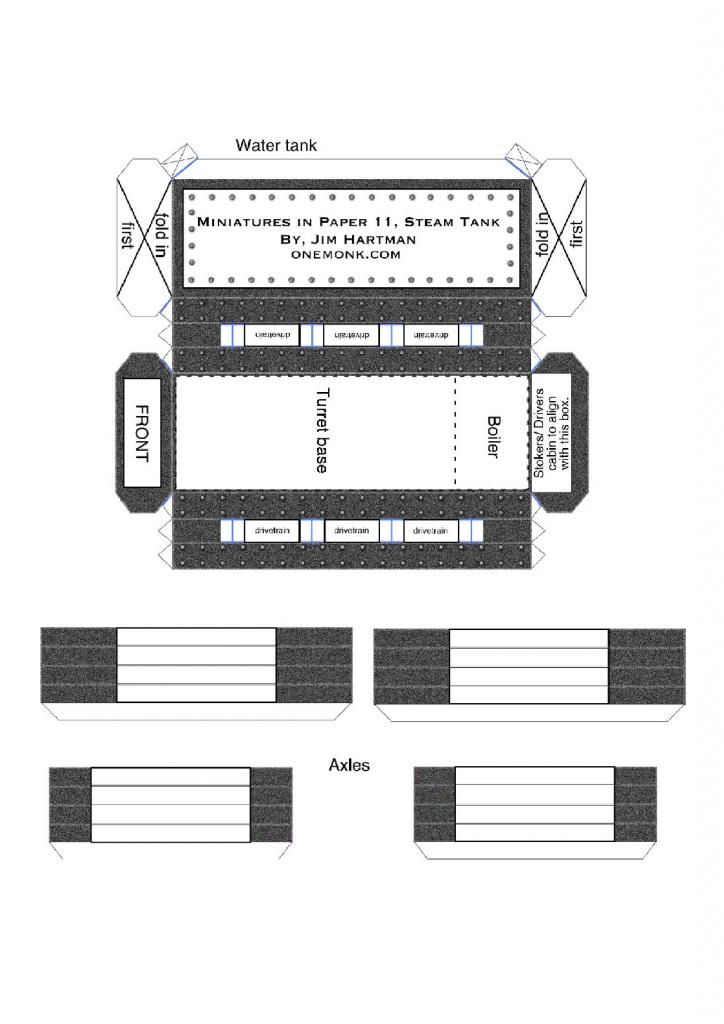

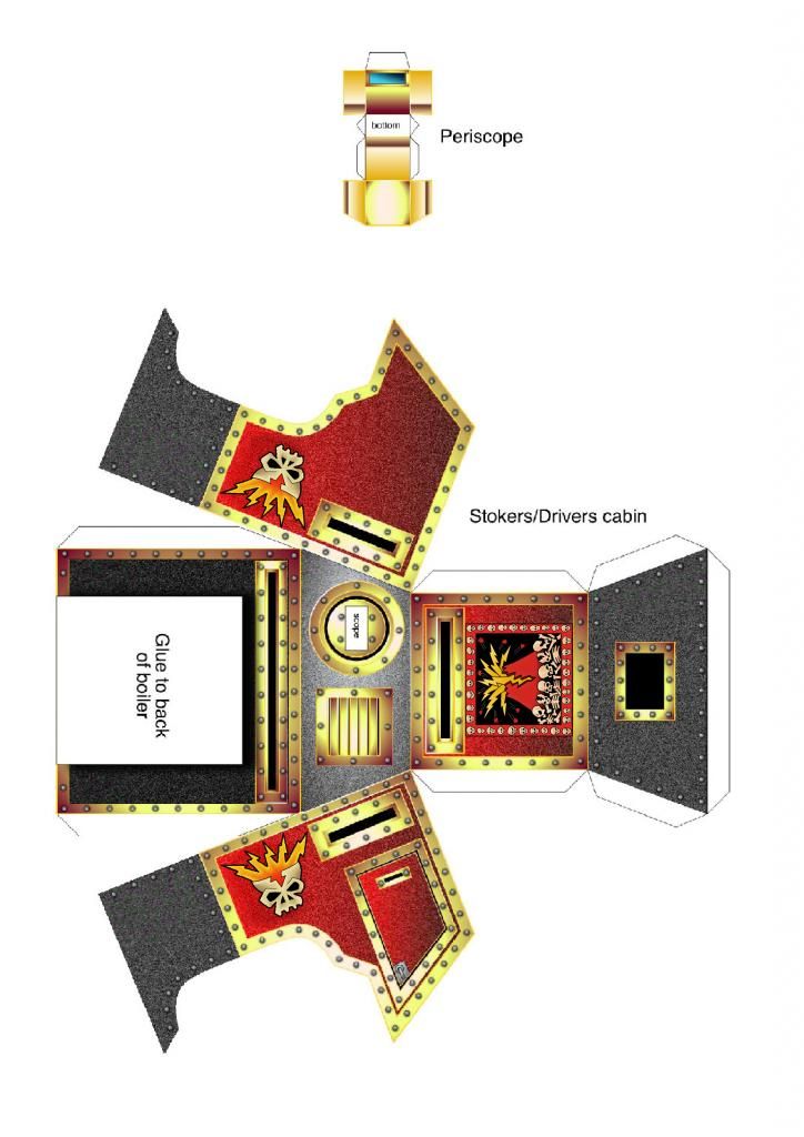

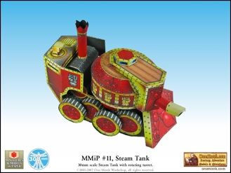

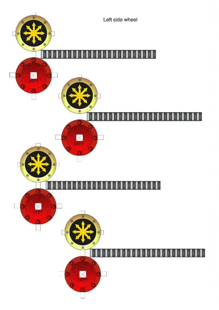

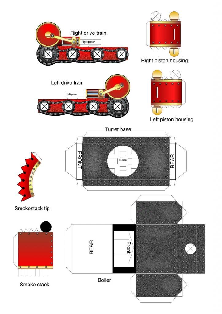

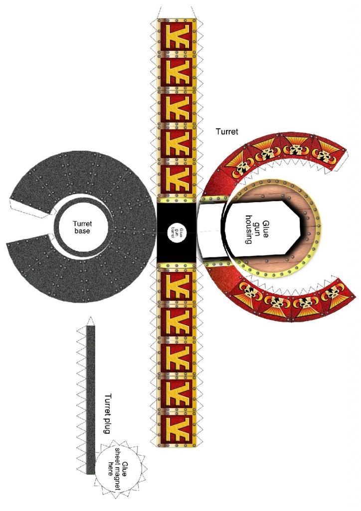

Ok I spent the morning looking for some Iron Daemon alternative. (and I still am! Help!!!)
Aside the empire steam tank, both new and old model I couldnt find much.

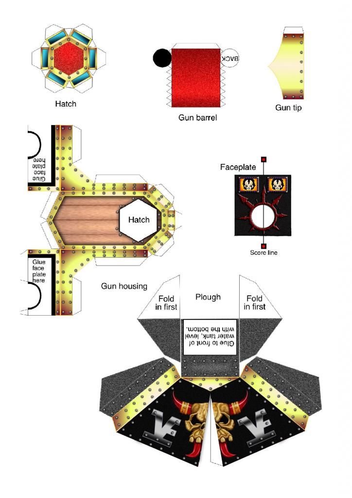

BUT I found this:
It is a papercraft, but if done correctly can look really good.
This is the direct link for download it.
http://onemonk.com/onemonk-dl_files/Steam-Tank.zip
But even better, In 1 hour or so I made few changes with photoshop for create a proper chaos dwarf version, I’m going to link here the pics I modified.
HERE IS THE LINK FOR DOWNLOAD THE CS5 PICTURES AND THE ORIGINAL ONE INSEDE
http://www.megafileupload.com/en/file/609430/ChaosDwarf-SteamTank-rar.html
SLIDESHOW HERE
Photobucket
REMEMBER TO PRINT THE WHEEL PAGE TWICE
I still have the CS5 version of the file, so that you can easily edit it if you wanna put other icons or whatever, so in case PM me, I have the originals in Higher quality.
In the end, I’m sorry for the wall of text/pics :frowning:
Hope it might be of help for any of you that like me are trying to find something else than the FW Iron Daemon.
Good work. It would look especially good if one was to make it in plasticard.

Maybe using the thin one might be possible to be done. But how can you cover it? How can you put the "paper base" on it? Just glue?
What are the most common size of plasticard used for create stuff? 1 and 2mm?
Any link where eventually buy the most commons size, sheet and shapes of plasticard? I have none.

Glue could maybe work if one was to do it in plasticard with paper on top, but if I was to build one, I’d do it entirely out of plasticard with green stuff covering for the joints, and make all the separate details (rivets, plates, decorations) as raised details by applying more layers of plasticard to the hull, just like it looks on normal miniatures. The paper templates would only be used as templates to draw on the plasticard with.
We bought a little Galeforce 9 plasticard from Waylands some time ago, but I’m sure that isn’t an economic investment for acquiring enough plasticard sheets for a whole Iron Daemon. Here are some links that hopefully could help you:
Warseer & Dakkadakka threads on plasticard.
Antics shop
E.M.A. hobby supplies. They have plasticard, plastic tubing and all sorts of things.
2mm & 1mm sheets on Ebay.
As said, just run the knife along a metal ruler to score it. You may need to do two runs with the knife, then just snap it off. Never try and cut all the way through it in one go.
Tinners
It seems 1mm and 2mm thicknesses are the way to go for vehicles, according to some scratchbuilders on Dakkadakka. You might also want to build some form of simple, internal structure to stiffen up the build. Logs like this Warseer log could be good to look at for visual examples of what to aim for with plasticard.
I hope it helps. :hat off

YES! I saw it this morning and it gave me the idea of recreate the template myself, only after I lost the thread so I couldnt quote you in it.
I saw it took almost 10h right? Made just of paper? In what condition is still?
I wanna give a try for 2 of them with plasticard as I will order it.
cornixt:
It is still together, except for the cowcatcher which is not strongly attached. The wheels are surprisingly rigid and the rest has held up well. I only used 50lb card, which is thinner than most papercrafters use. It was a fun project, much harder than I thought it would be. The cutting and scoring alone took a long time.
I doubt you could make the curved sections in plasticard without considerable difficulty. There are some tight tolerances when it comes to sticking sections together, so you’d have to allow for the thickness of the plasticard.
You can get plasticard that’s somewhere between paper and very thin card.  You can cut it easily with scissors.  I’d definitely use that as a minimum just for longevity.
Loidrial:
I doubt you could make the curved sections in plasticard without considerable difficulty. There are some tight tolerances when it comes to sticking sections together, so you'd have to allow for the thickness of the plasticard.

I will have the 0.5mm and 1mm plasticard, 3 sheets each, I think I will be able to pull rabbit out of the cilinder.

Check on top of the thread, i put the caps lock on my link where you can find the big pictures and photoshop files, I wanna see if you will try to make something with it!!
I guess the idea is to print all the pages, than cut them and draw back on plasticard.
Cut it too and waste hours of time, skin, sweat, curses for create something cheap and cool.
Dînadan:
This is great. I want to try to.
Is it possible to print plasticard?
gIL^
Don't think so; be easier to print on paper, cut them out and then use those as templates to cut out the relevant shapes in plasticard.
I don’t see why you couldn’t print on it tbh, but it would have to be really thin and you’d have to use a laser printer.
A paperdemon - that’s brilliant. Good work laying that one out in the first place. From this print it would be fairly straight forward to fold this from thin plastic cardboard. I think this will be my second Iron Demon at some point. With a bit of extra added details ofcause.
Quick tip: You could build one paperdemon first, to become familiar with the construction. Then go for the plasticard variant. :slight_smile:
