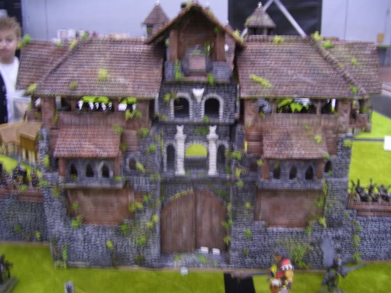

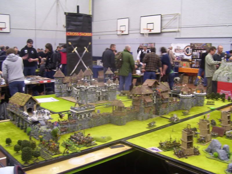

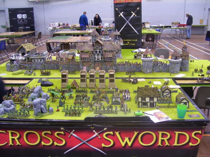

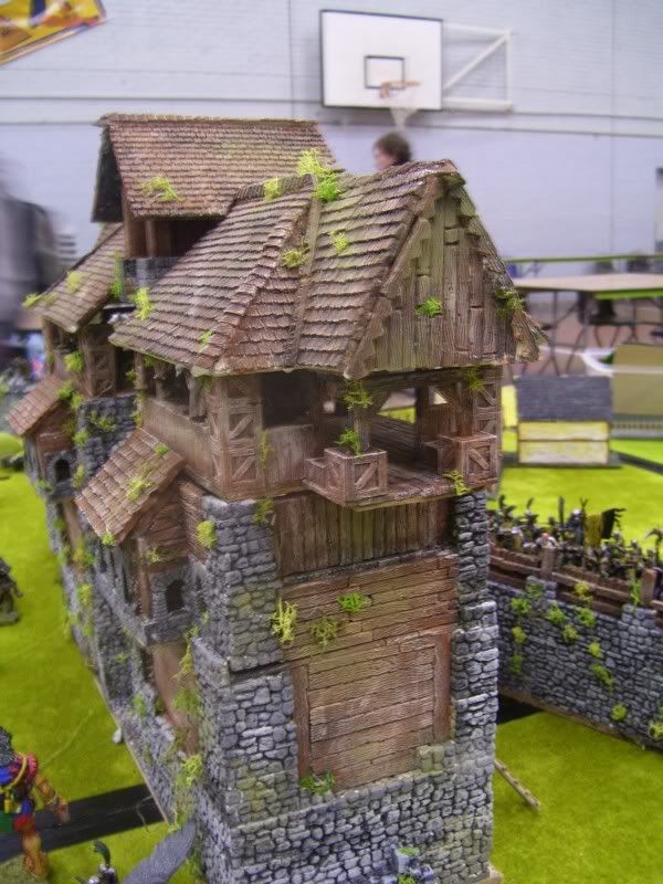

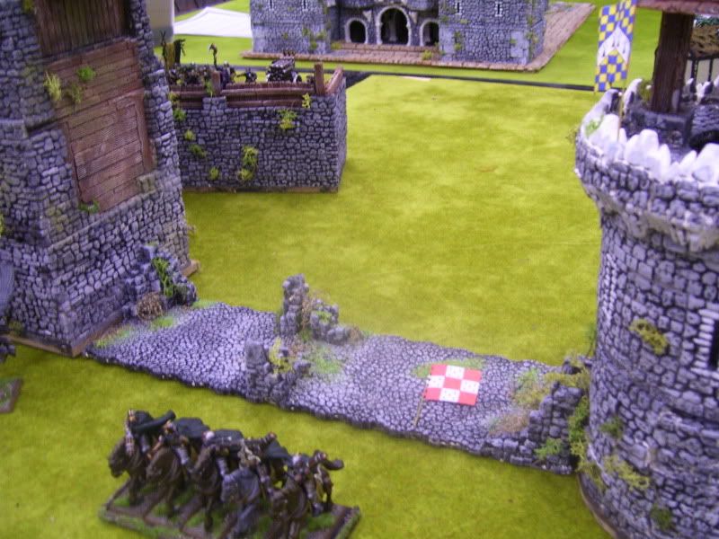

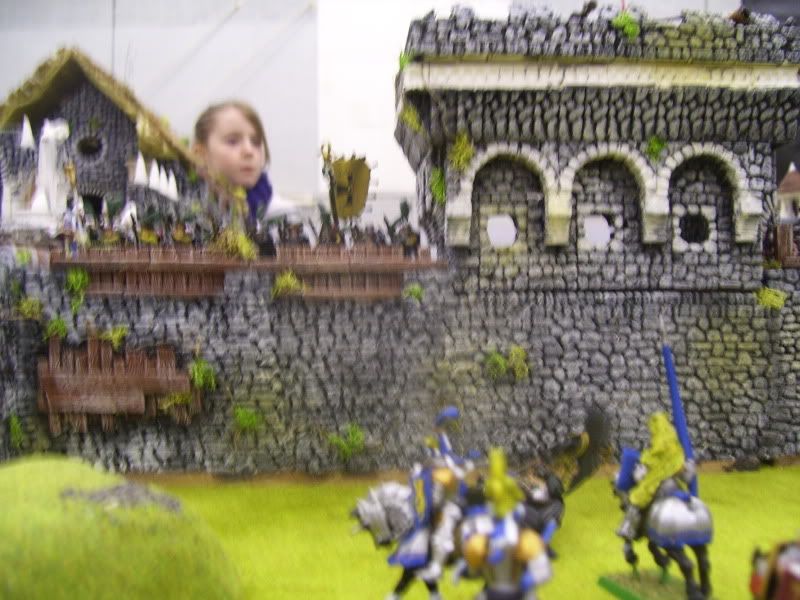

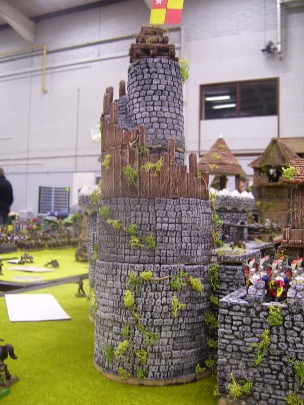

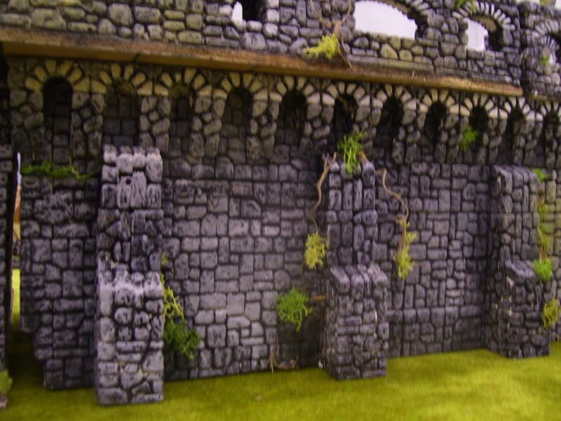

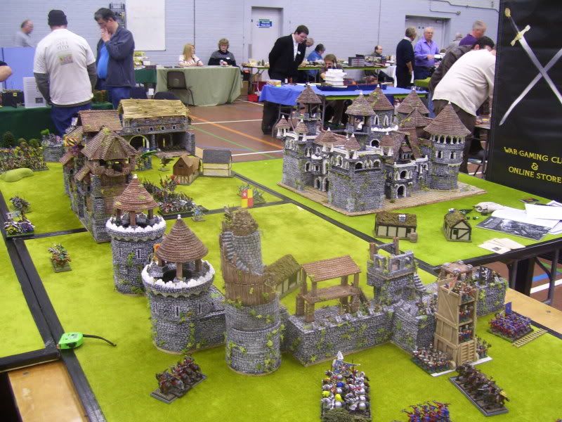

getting back into the painting saddle after another large project, a siege for a participation game at a local show. the castle took about 8 months to build luckily 3 weeks to paint. since finishing the “beast”. its being used as the centrepiece for some campaign weekends with some friends. these are in the planning stage with all sorts distractions, pitfalls and bonuses. anyway the pictures
and then some random shots
the wall sections had replacements for breaches
finally

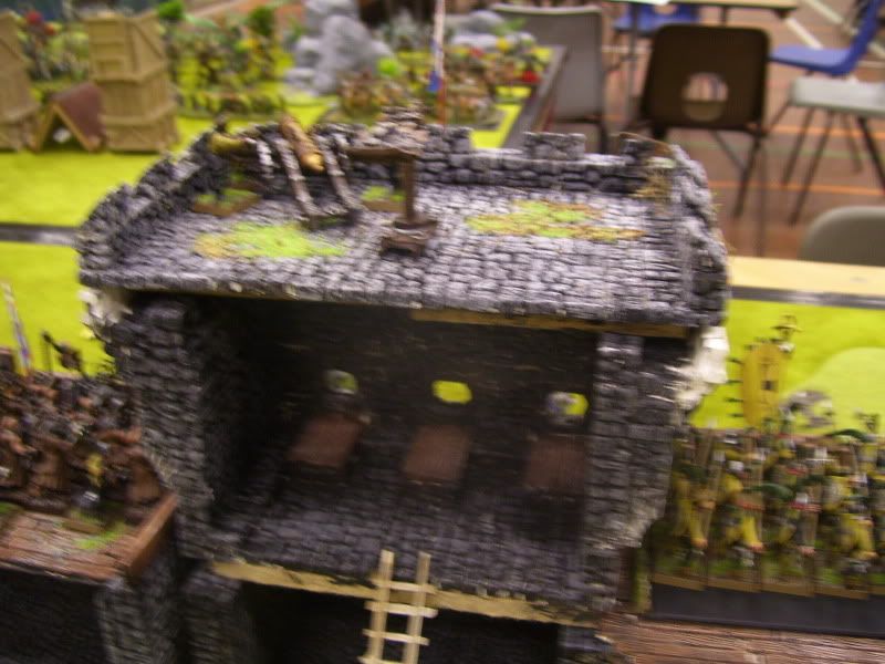

Amazing! Nice touch the destroyed section. Is it removable? To show where the wall fall down because of siege machines?

the castle and walls are all made from hirst arts molds, basically single bricks 1" long each. i’m not that computer literate (on the hirst arts forum they’ve done sketchup files so people can do there own 3d models ) so the whole process for me was quite organic.
essentially castles are quite boring to look at lots of sheer granite faces, so the challenge was to find a compromise of something that looked good but was also attackable to make the game more intresting.
this was my second large project, i used my “previous” and set myself a goal of completing a section a week, each piece was about 10" long and is mounted on mdf. I tried to stick to a regime of 3 castings a daywhich probably took 15 mins each session , that stockpile gave enough bricks for adays building. hence the amount of wooden hoarding which gave my bricks a bit of a breather.
the keep is big enough to play a heroquest/d&d game in and sadly is largely redundent in the siege game but hey ho. there are some objectives and a second gatehousewhich help to add an extra dimension to the game.
there are ruined sections of wall which are the same size as the whole pieces. when a section is destroyed we just slide out the whole piece and replace with the ruined section.
the castle is made up from 5 of the hirst arts molds which was my main expense, the plaster cost £30 (just under 2 sacks) and was painted with kids paints black, white & brown £5 then just pva glue and some mdf. was offered cash for it on the day but turned it down. it took too much to do just to have one game on it!! am hoping the campaign weekends lives up to expectations, one of them is planned for the end of oct

@Necrotique no such luck, £250 on the day and an offer of £400 came in later, though compared to 8 fortresses from games workshop still doesn’t compare size wise, the curtain wall extends to almost 10 ft and the keep itself is on a 4ft X 2ft board,
each storey happily accomodates character models with most weapons.
the gatehouse is 5 1/2 storeys high
the highest room on the tallest tower is 6 storeys high almost 3 ft
