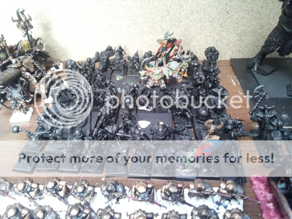

Guys you all rock. Thanks heaps for the tips. Seriously thanks heaps, so much good info. Dipping looks like the way i’ll probably go. Here are some pix, they arn’t just hobgobbos they are slave units that have all sorts of greenskins but they will be played that way.
Here’s the first block minus a few extra standard bearers and unit fillers that are ogres:

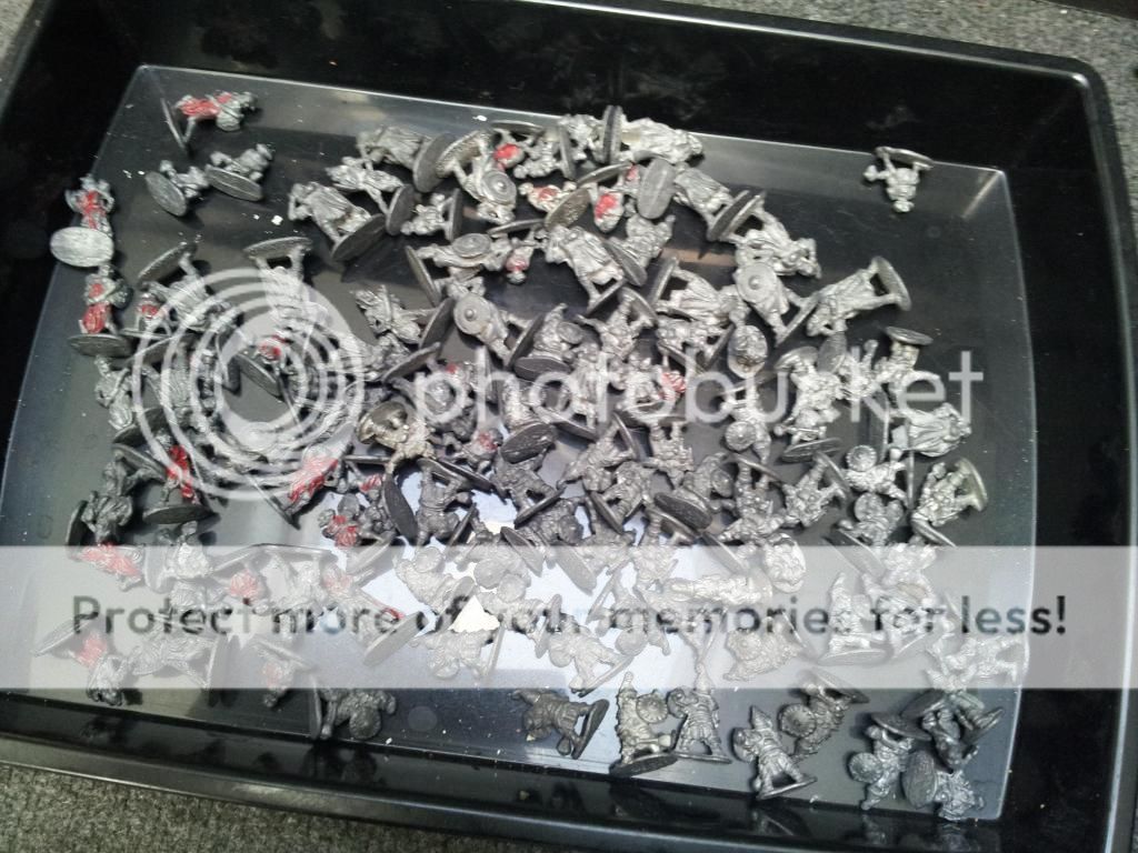

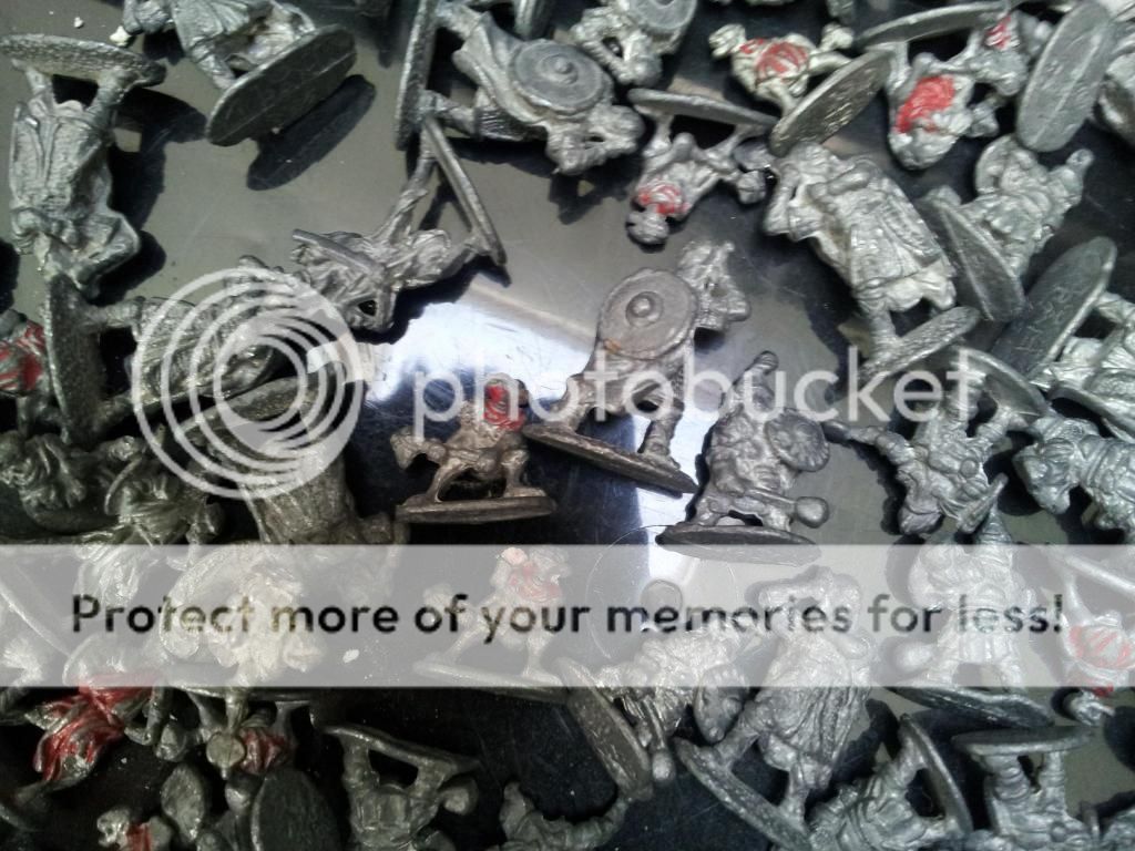

And here is the old school minis i scored, and i got a few more in bits i need to sort out :wink:
Nice! Just be sure to remove the mouldlines. :wink:
Dipping is time-saving, but leaves the models irrevocably glossy. If it wasn’t for speed I’d recommend brown-spraying and then batch painting them, one colour at a time with normal washing and highlighting, if you want a better look. It won’t be as fast as dipping, but would give you a result to be satisfied with for years to come.
