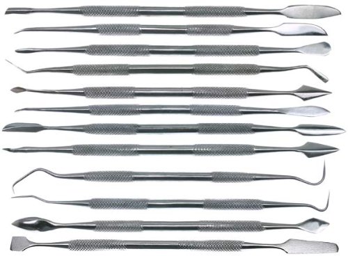

Keeping tools wet.
Everyone knows this. Bear in mind as well that if your tools are dripping wet you�?Tll never be able to get the putty to stick on in the first place!
