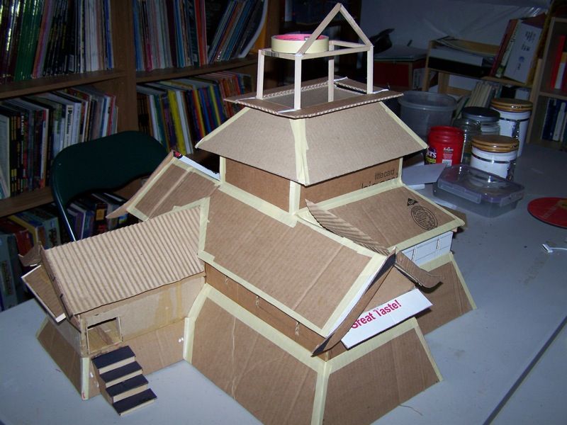

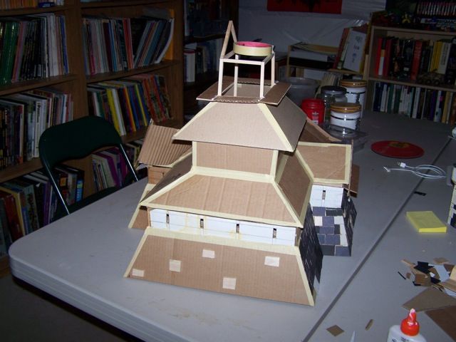

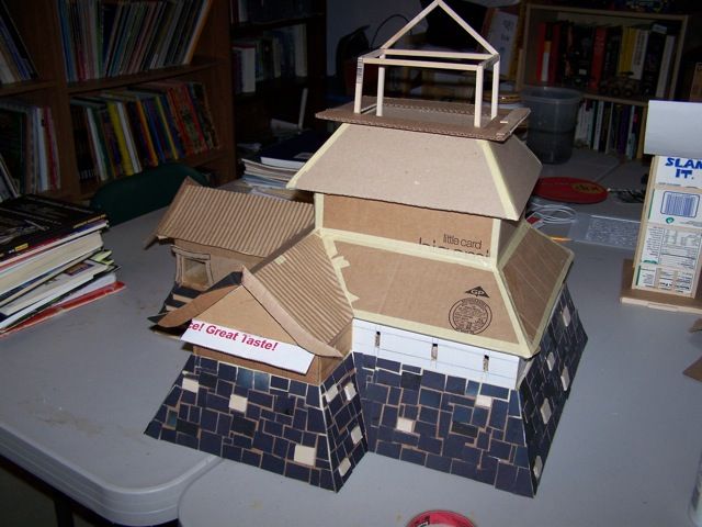

Castle Update
Didn’t feel like working on the army tonight so I worked on the castle instead. That’s one nice thing about doing both simultaneously, I can work on the one that strikes my interest on a given night.
Right now I’m at the major milestone for the castle it wont be getting any taller. For scale I think its good compared to GW scenery or other scenery I’ve made, but as I’ve said all along. Castles are big!
I didn’t take any close ups of the roofs but Ive worked out a way to do terra-cotta looking roofs. I take large sheets of cardboard ans soak them for a few minutes to loosen the glue. Once its loosens its a simple matter to pull off the parts you want. Let them dry and when ready glue them on. (the masking tape is bracing stuff while it dries.)
I vaguely remembered the idea form a White Dwarf and sure enough I dug out issue #266 and the article was there.
I also have some left over Spackle to use to fill in ends of walls where the cardboard shows through and other goofs spots.
Next up is glue the third level roofs (they are only taped right now and finishing the upper deck and upper roof. From there its time for more roof sections. The base with what will be stone is a job for when I feel like doing something mindless
Anyways here it is as it stands now.

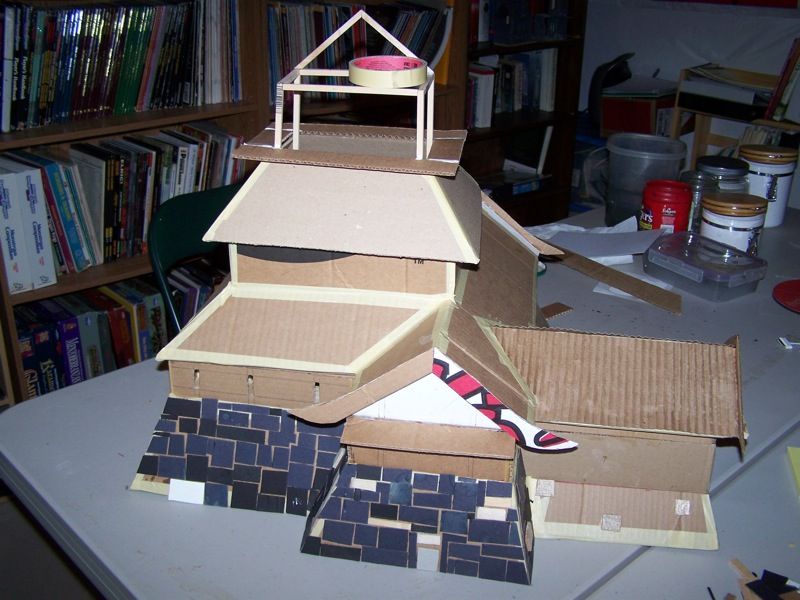

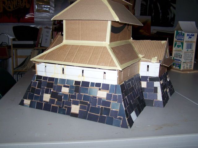

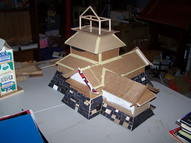

Castle update
So one month later… This didn’t take me one month of work more like a couple of days off and on. So what did I accomplish? Take a look at the lower walls… that’s a lot to glue on! :o
I’ve also got my technique for separating the glue from the backing on cardboard which I’m using for the roofs.
1. Cut the cardboard out so it fits in a sink, (kitchen works best).
2. Use warm but not to warm water.
3. Leave the cardboard in only long enough to get it to separate, usually no more then 2-3 minutes tops. Otherwise it will over saturate and flatten the cardboard, what you are trying to preserve is the ridges.
4. Find a flat place for the sections to dry.
Anyways here is my progress thus far with the bases now done and the start of the roofs. The stairs and the doors to the entry hall need work, or in the case of the doors constructed.

Looking very nice! A question though, how do you paint cardboard? I have tried it in the past and always failed miserably…do you have some technique you can share with us? A sealer of some sort?

Nice! I only hope the structure will have enough stability and integrity from its skeleton framework to survive the many years it deserves to be used frequently in games. There are sturdier though less available and more expensive materials which could work instead of cardboard.

Looking very nice! A question though, how do you paint cardboard? I have tried it in the past and always failed miserably...do you have some technique you can share with us? A sealer of some sort?Spray paint- flat. I'm also experimenting with building spackle on the joint sections.

Nice! I only hope the structure will have enough stability and integrity from its skeleton framework to survive the many years it deserves to be used frequently in games. There are sturdier though less available and more expensive materials which could work instead of cardboard.The base is exceptionally sturdy, the frame will be getting reinforced. Ive worked on it a bit since these photos and the upper platform will be/is very sturdy as I'm gluing down Popsicle sticks similar to the main from which was solid when the glue dried.

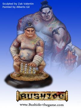

Anyone have an idea on scale on these? Particularity how they compare to ogres? My guess is they will be a bit smaller, question is how much?
Roughly the size of mantic ogres, but broader. Smaller than GWs.
But from the sound of it they are at least in the ballpark? Obviously I can built the bases up a bit too to compensate, I’ve already thought of the obvious like to rocks, put a few on a bamboo mat, that sort of stuff. EDIT: from the look of it the mini will work out in terms of scale.
Reason being these guys are going to be my ogres for the army. I’ve found one other sumo mini out there but it was fairly skinny.
