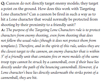

This is an interesting option too. I just fear all those ambushers. Hard to protect engines from them.
Well they can’t be targeted if within 3" of an infantry unit or war machine, that should give them some protection.
Biggest danger are always poisoned attacks. And our own capable Ambushers with BS4 and Multiple Shots (2) should not give a false impression here. I feel the majority of armies does not have particularly dangerous ambushers. Wood Elves, Skaven and Lizardmen come to mind. Plus a few with Scouts, but those are easier to deal with.
Cannons can and cannons are basically the only war machine I see in-mass.

Only a 1/6 chance, though. And if your opponent uses his cannon to go after your lone Daemonsmith instead of your Iron Daemon or Lammasu or Bale Taurus or Wyvern: Great, let him!
