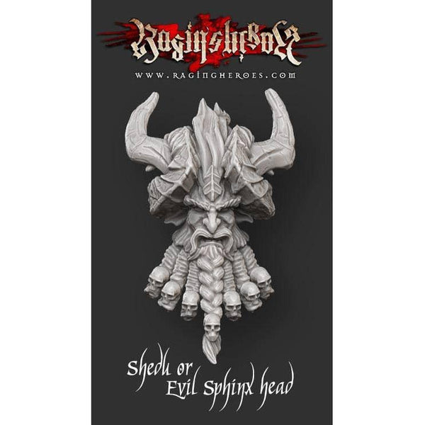

So I’m wracking my brain trying to think of good conversions/builds for a Lammasu/Lamassu out of current in-production GW miniatures and would like to get the forum’s opinions on the “best” or even “least worst” options - from a price vs effort perspective.
I’ve seen a few Lammasu built out of the current Chaos Manticore kit: most use the Raging Heroes Shedu head and one uses the old Lammasu head - is there another good head option using current GW parts? Or a reliable way to sculpt around an existing GW head? (I tried a Defiler mask; it’s too small).

One option I have seen is the GW Manticore, with a resin face (I can’t remember the company though, but they made Lamassu faces to attach to such models).
