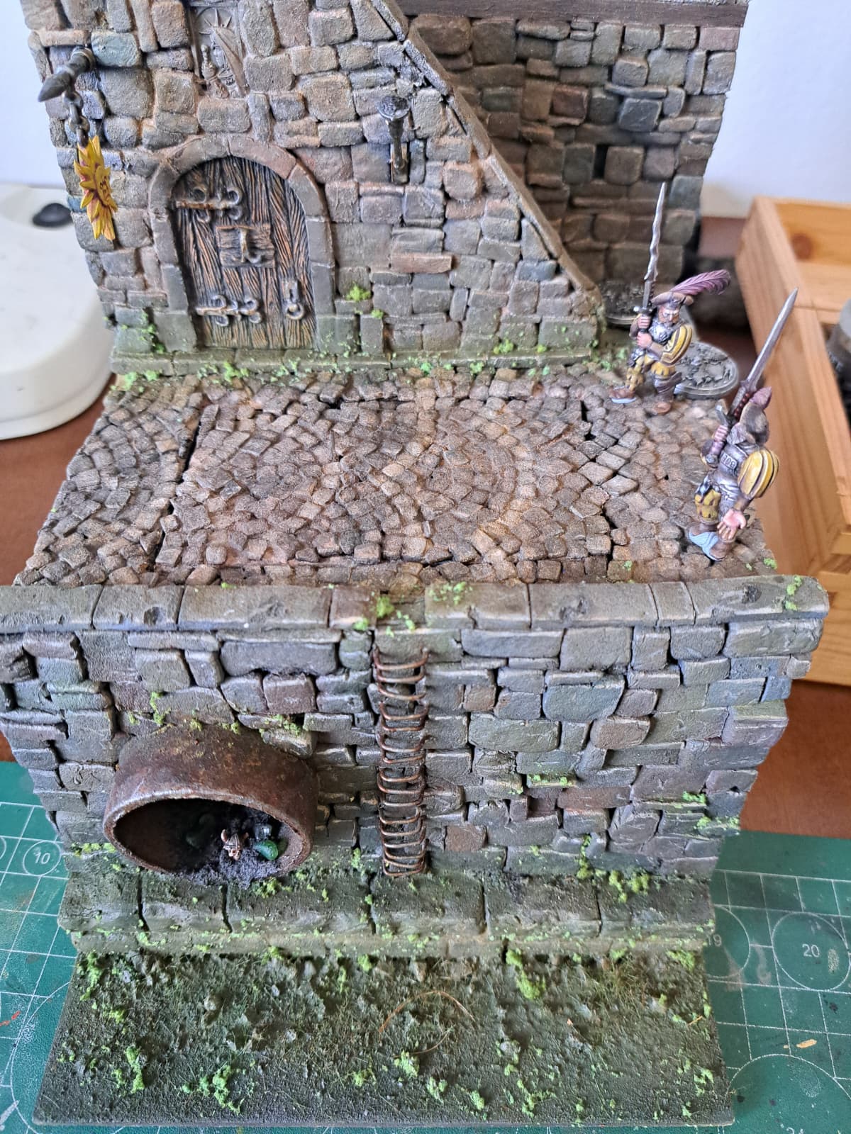

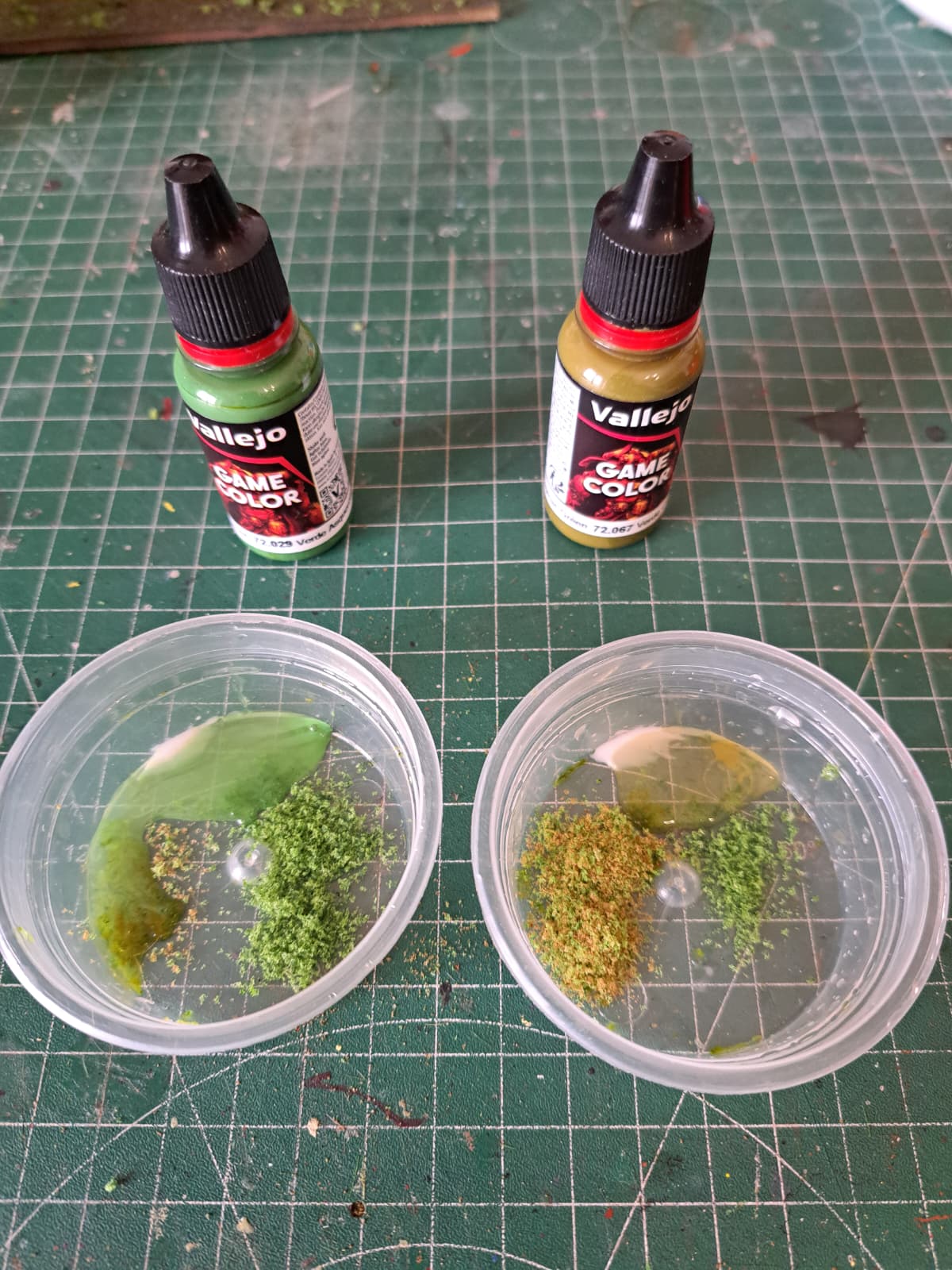

As I’m still working on a diorama I started time ago I thought someone might find this interesting this part so this is how im making those Moss pulps

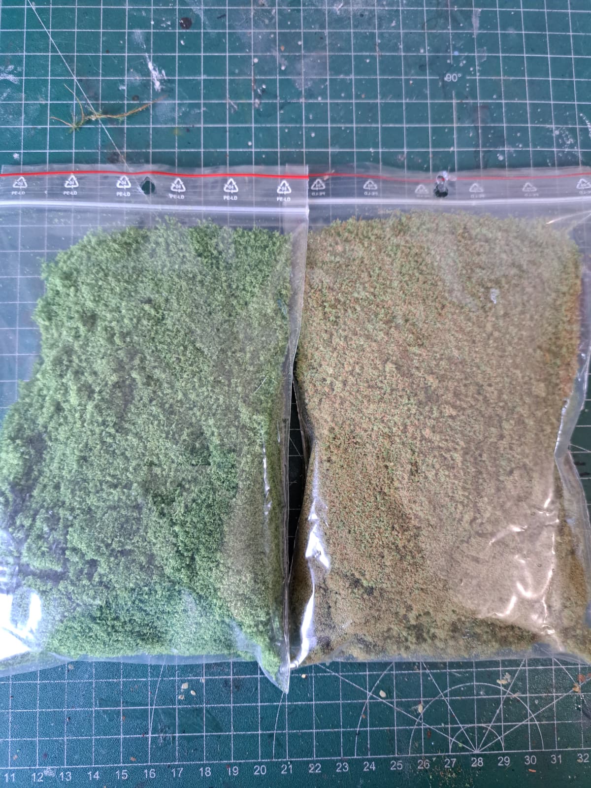

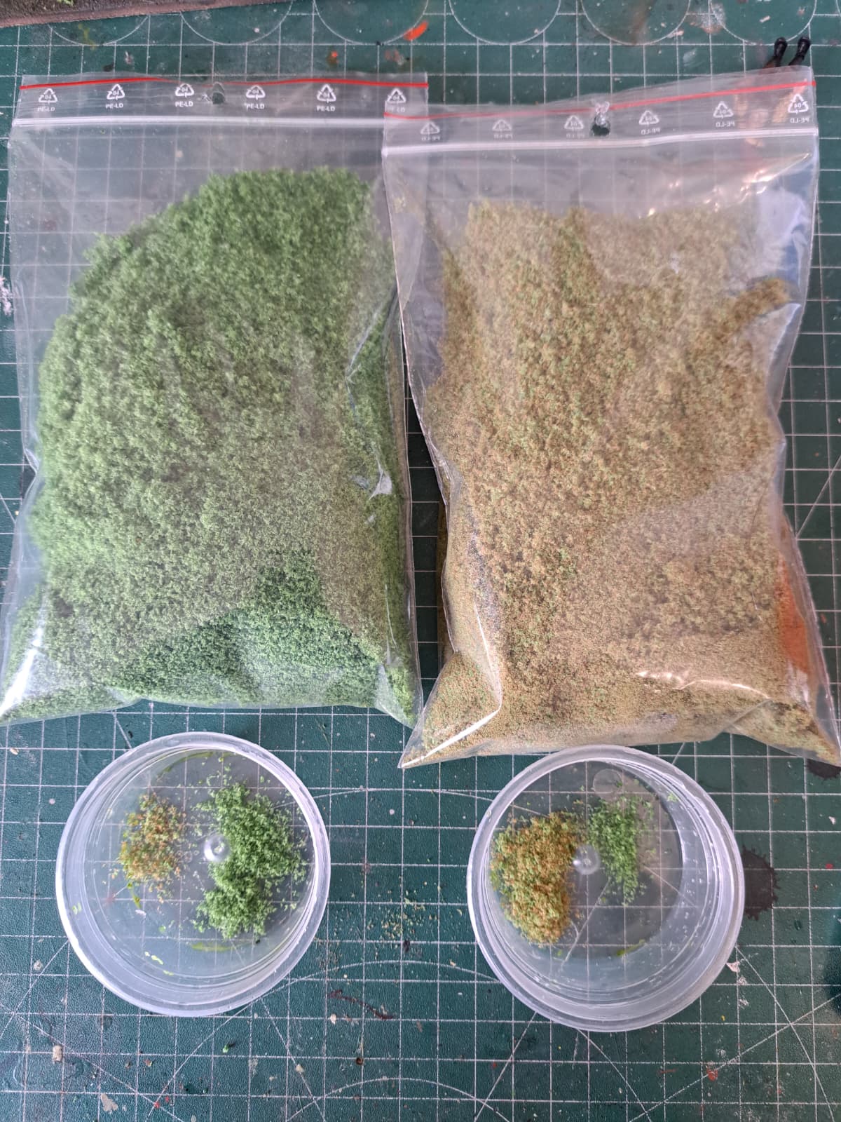

1- 2 different colours of clump flock

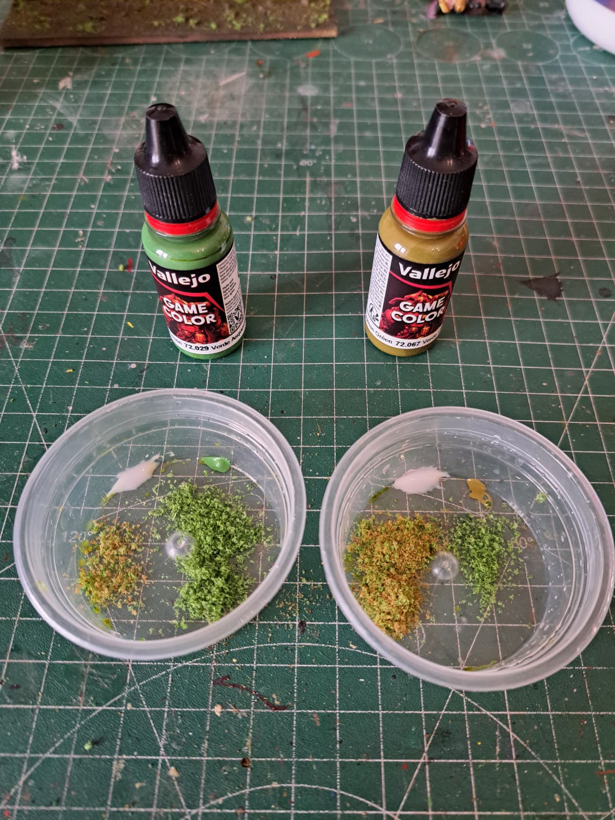

2- make 2 batches of 75/25 part of the 2 colours, so there Will Always be some minor colour showing through
3- add a Little drop of colours so it Will glaze a bit when applying the Moss, and a drop of PVA glue to Stick it down
4- some water and the mix It whole

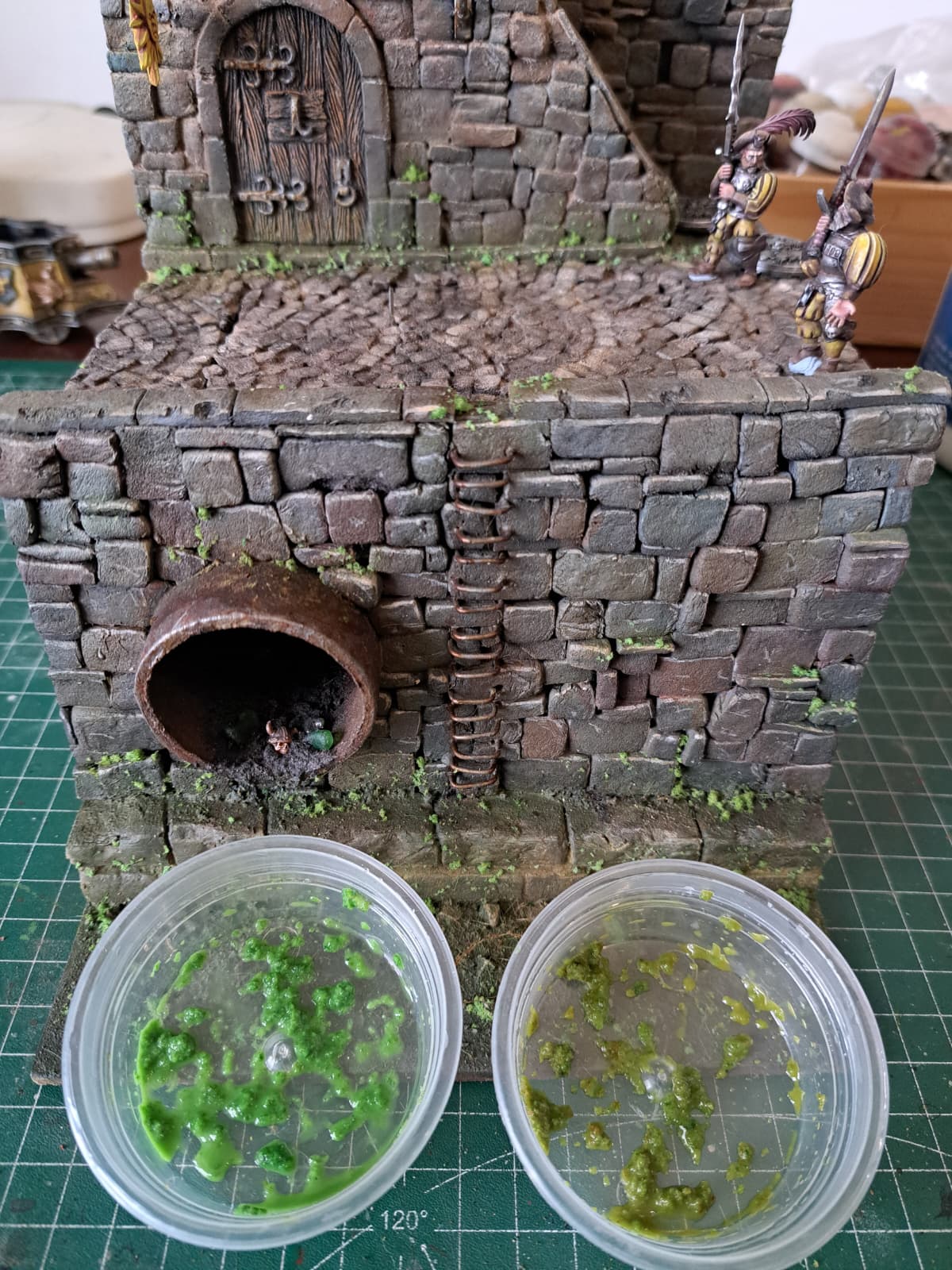

5- when you have those Little pulps use and old brush and start apply the shit anywhere Is needed
6- profit?

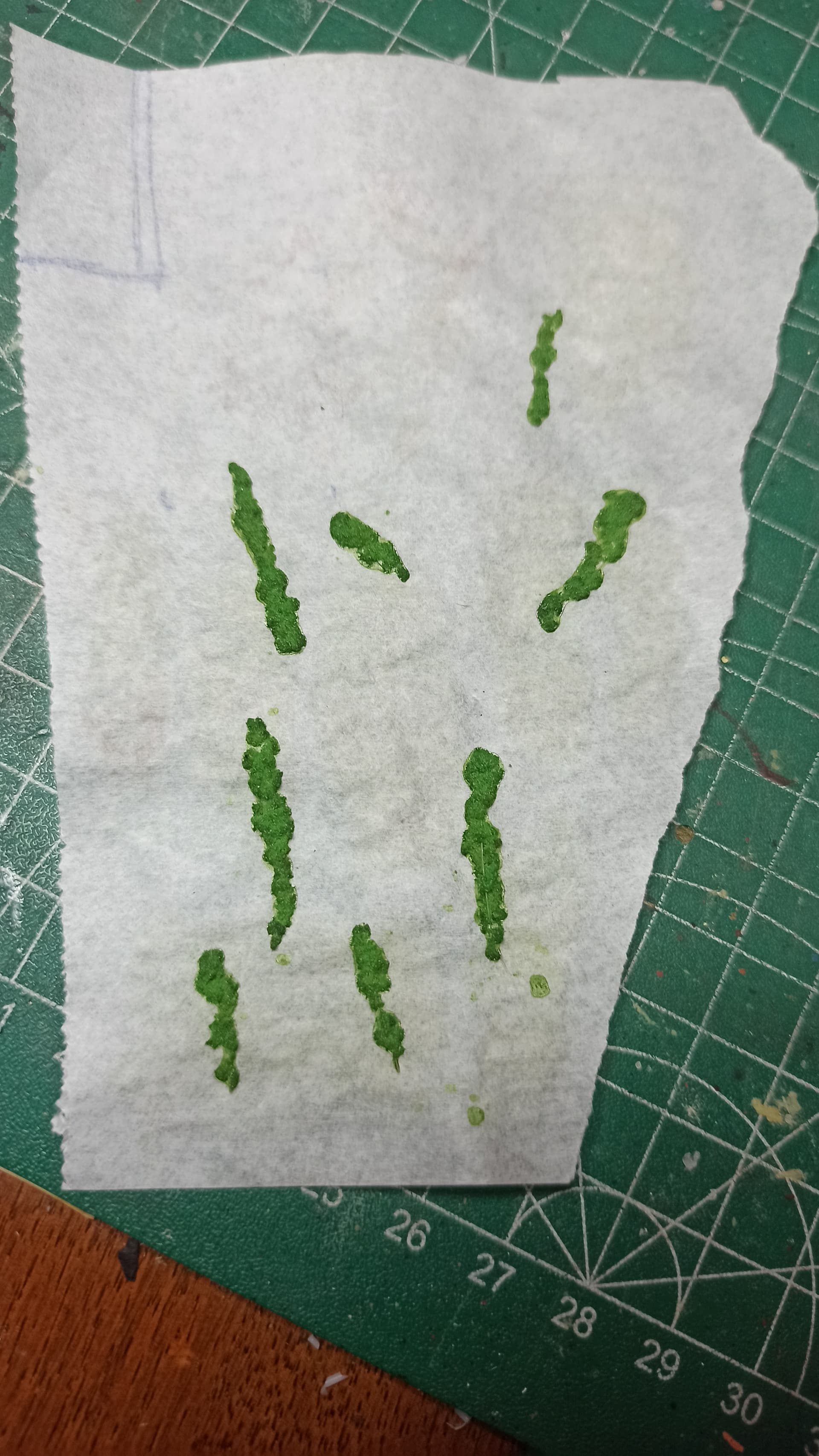

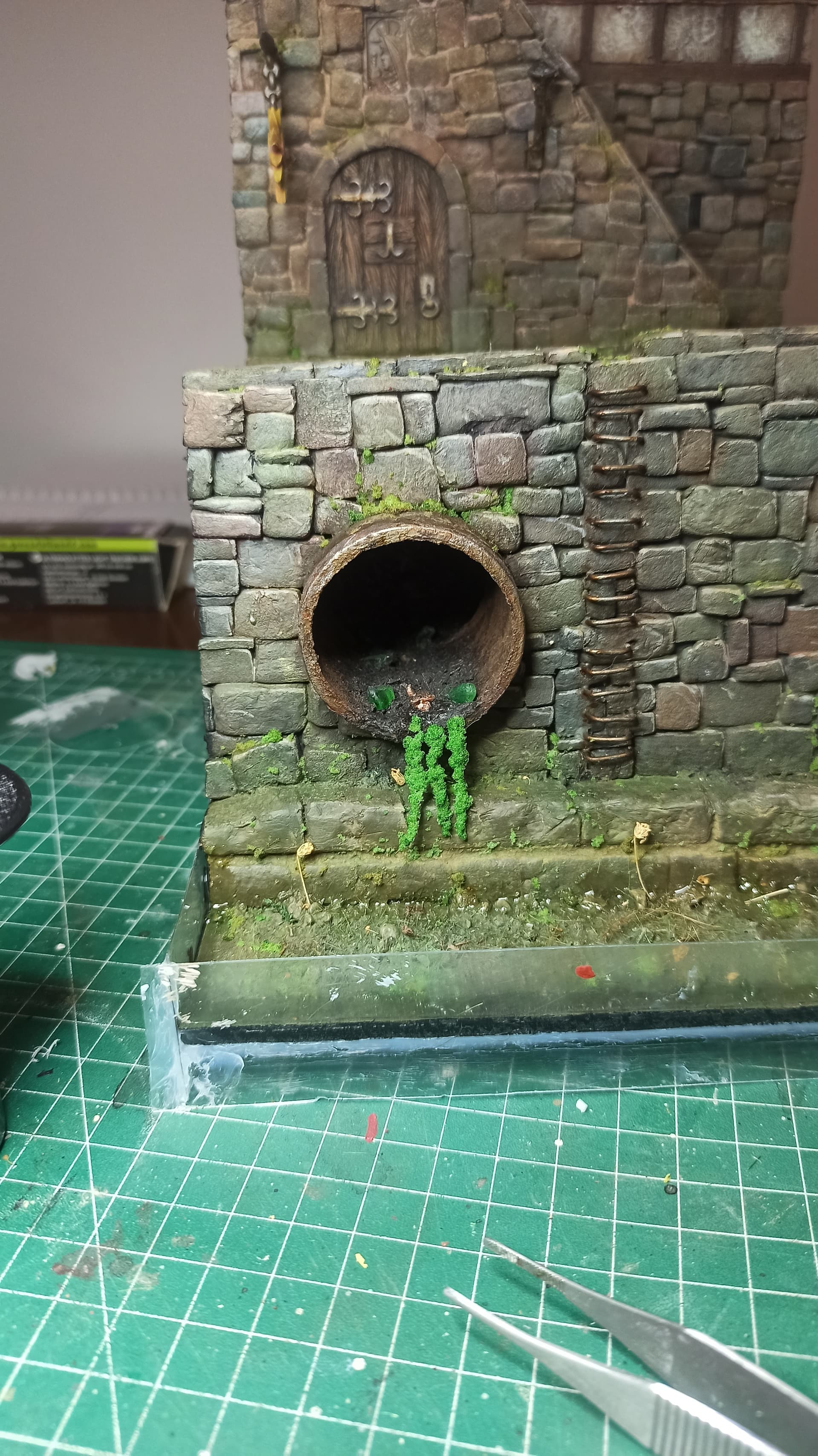

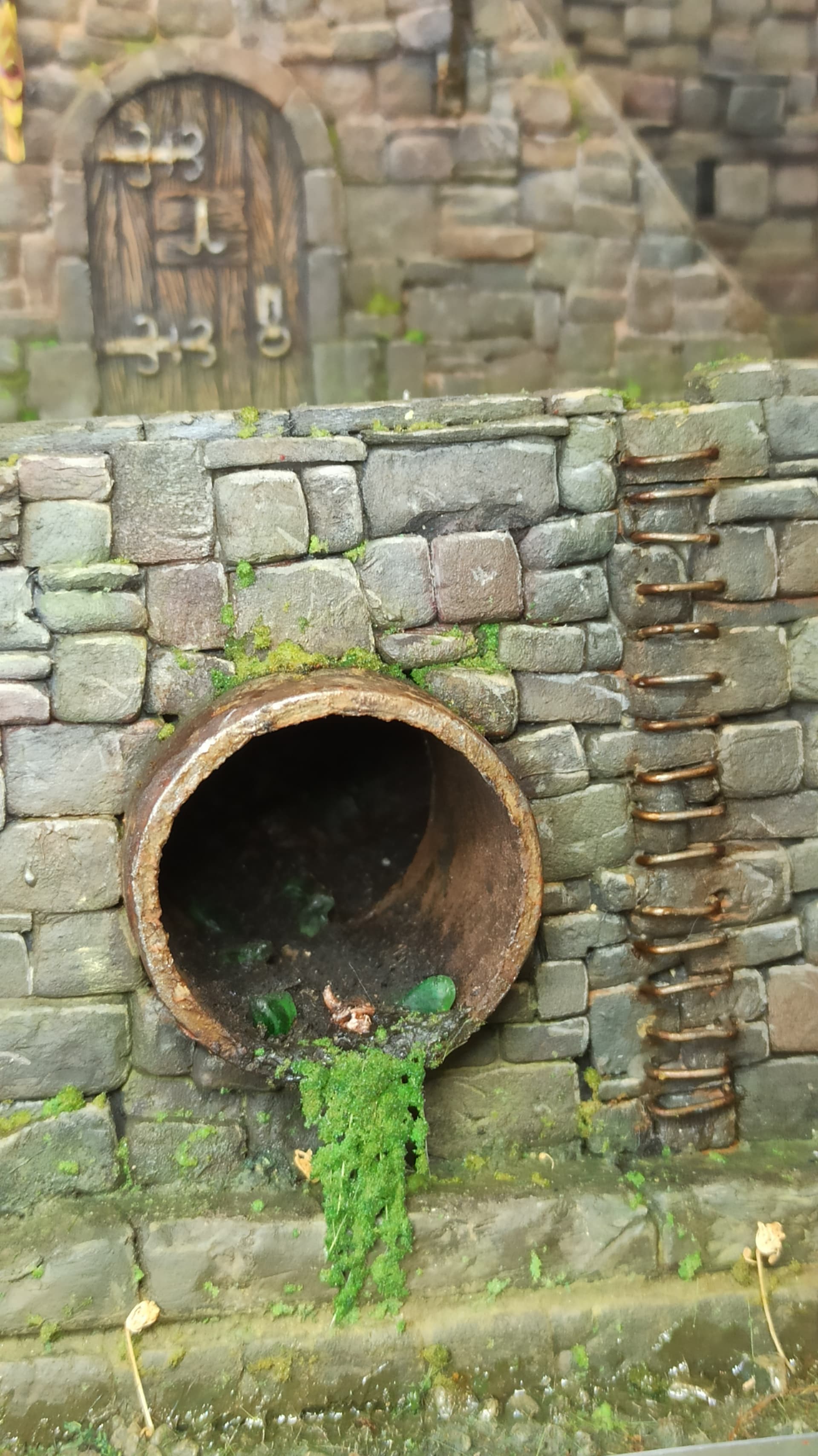

For create vines I’m using the same base, but I add an extra step, I put down on some baking paper a single hair of an old brush and then I place the moss pulp mix on it so I make the single strands
Then after it dries I remove it from the paper and try some shapes
That’s it, pretty easy luckily
