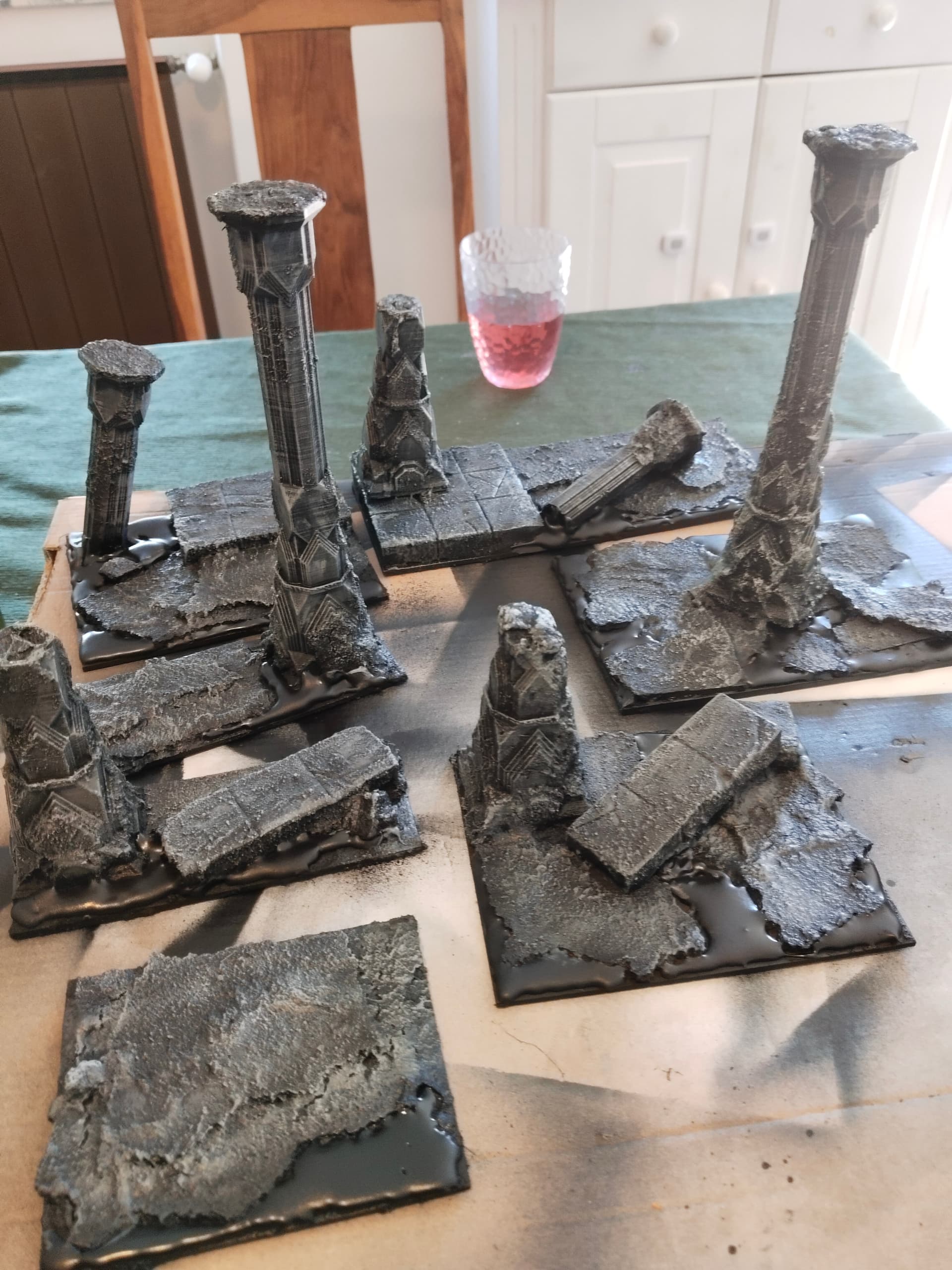

I am working on my chaos dwarf/abyssal dwarf army for kingsofwar.. for the diorama bases I decided to go with a “dark dwarf ruins” vibe & lava rivers inbetween to add glow effect to the miniatures.. I have built armies with glow effect before but lava works differently.. anyone got ADVICE for videos describing “reverse zenithal” ? (meaning that you start with the dark colors? Any advice welcome!
Pictures of the still “unairbrushed” bases for attention :slight_smile:
I’m afraid I cannot help you much since I have no experience with airbrushing. However, I must ask: where are these pieces from? They look great!

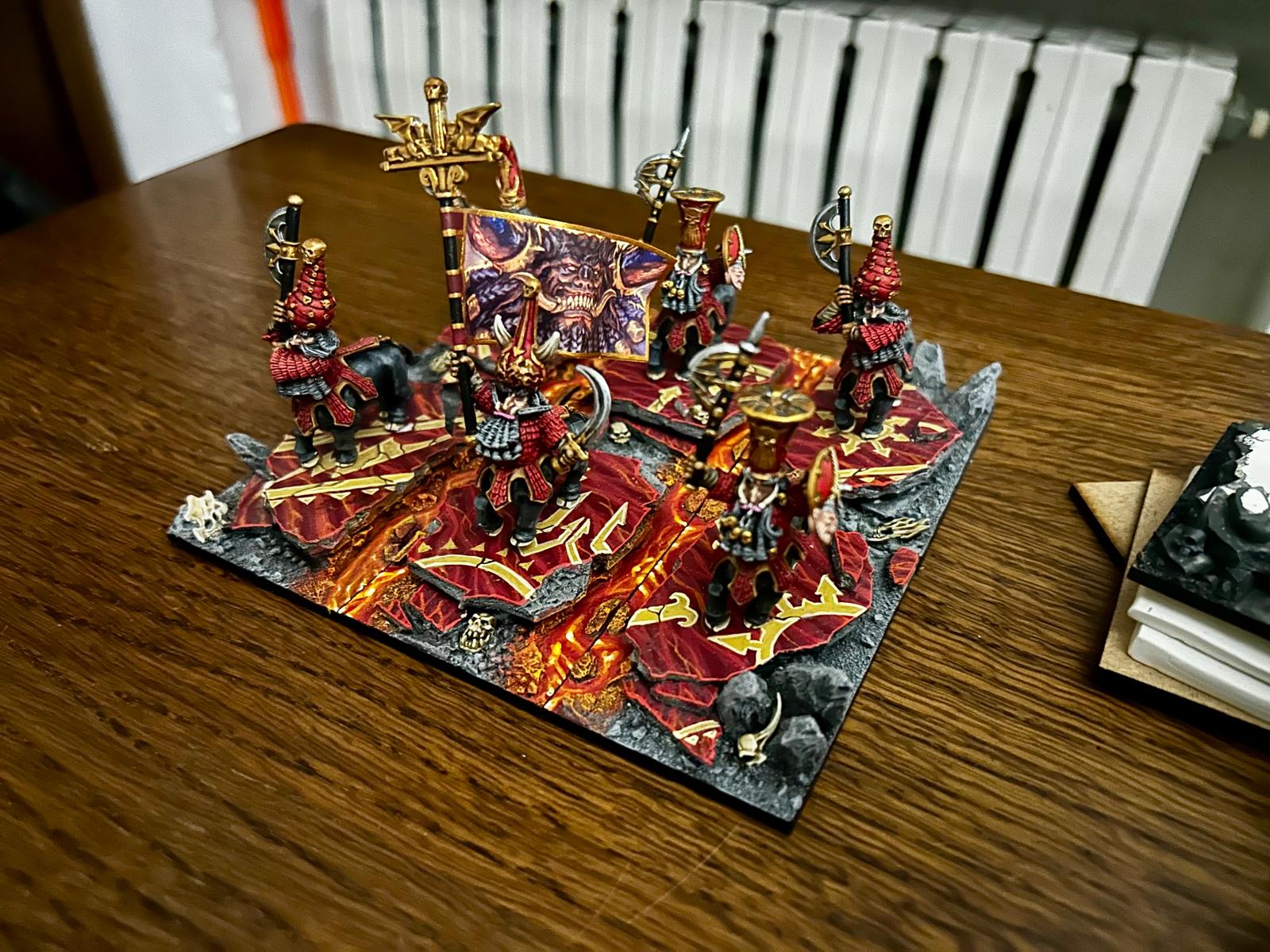

to me, here the mega master is @Skink
this is the kind of work he does

The bases? Thanks! The dwarfen columns are 3d-prints, the rest is made from cork, glue, sand & hot glue
They look great! My main problem is that I want to give the miniatures next to the lava streams a glow - & normally I go from lightest to darkest color.. I think with lava it has to be the opposite direction though?

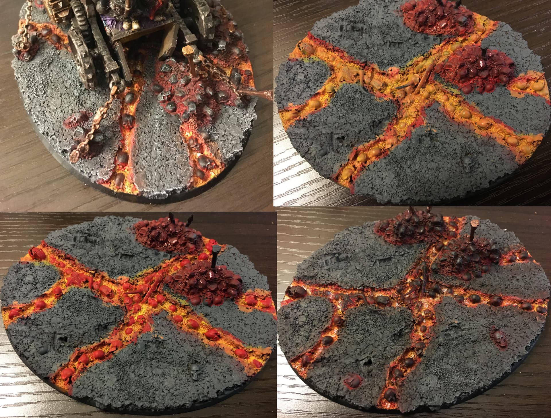

Not really a full description but typically over black you need the basecolor the areas that will have lava back to white, so that additional layers of red/orange/yellow have the appropriate brightness on top. If looking for professional advice, Id watch some elministura content (https://www.youtube.com/channel/UCLNwkLh6qpHPIp4y2pxGPMw)

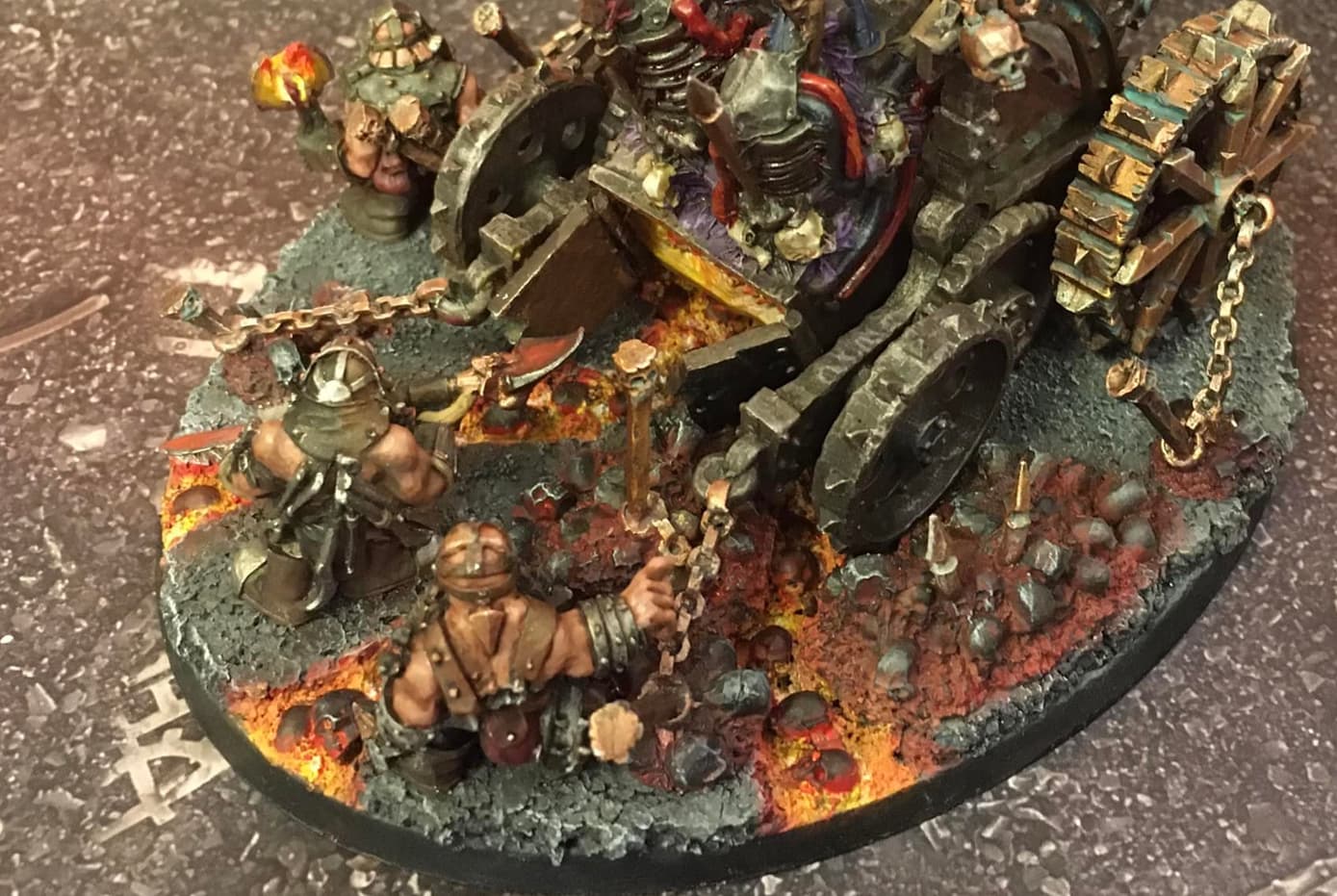

But to give you an example I did by hand with no airbrush on my Hellcannon:
The Final whites added on top were probably pallid wych flesh then some vallejo white. The blacks need to provide contrast so they eye knows whats up
