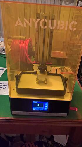

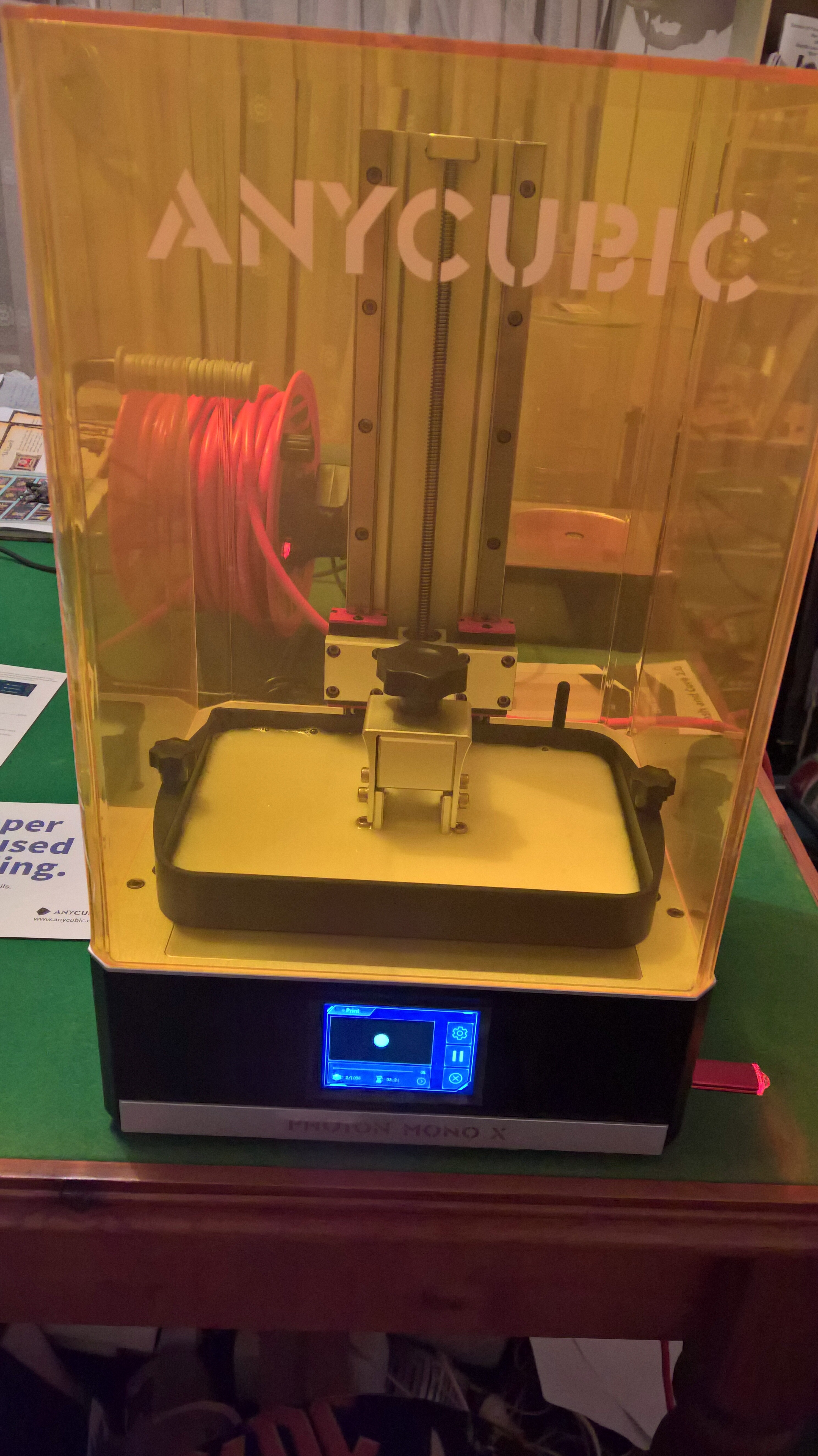

Bloody jinxed myself, the files come up but it does not want to print them, incorrect parameters its telling me so I told the cheeky bugga to print the test object it came with to make sure the bastard actually works and it seems happy doing that, going to take 3 hours it reckons so I might have a short kip and see what happens then try work out what went wrong with the slice on my model when its done.
Not much to see but there she is in action
