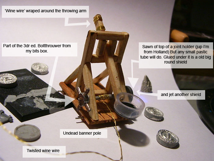

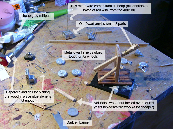

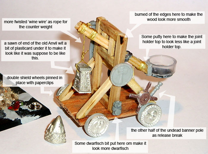

I’ve had some experience with scratch build war-machines, I didndt like the Dwarf Grudge throuwer model and the old very cool goblobber is to rare/expensive so i build a Rocklobber.

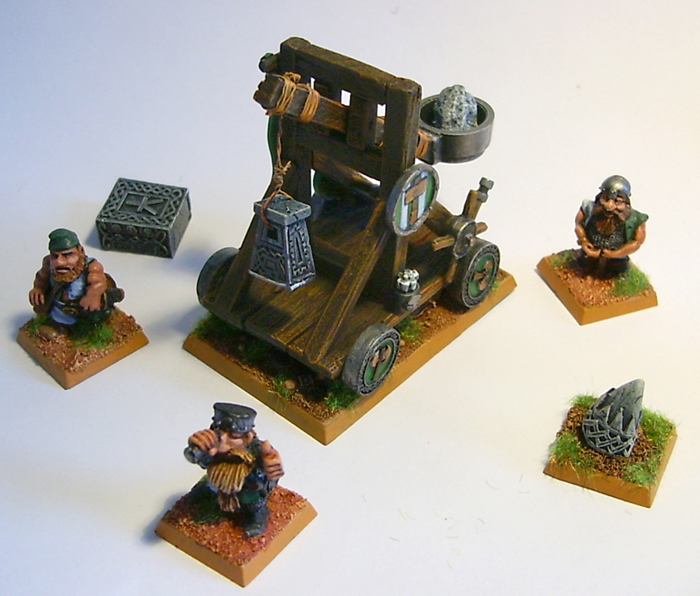

(a step by step set of pictures here explains some of the techniques I also used for the Earthshaker pic01, pic02, pic03,finished model)
some more work on the frames, and I smoothed the center and the front with greenstuff. If I had a PVC pipe I would have stuck this in the middle to get a perfect round hole but alas. I filled the back of the hole of the cannon with chewing gum (cheaper than greenstuff).
