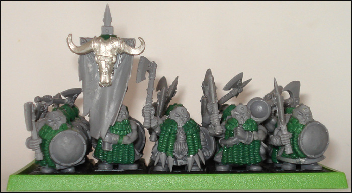

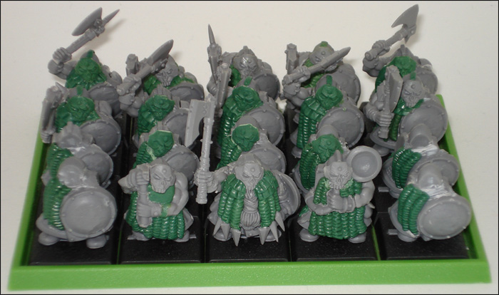

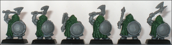

Like many others, I have been inspired by Exquisite Evil’s work with the Battle for Skull Pass Dwarfs. I ordered 48 Dwarf Warriors from http://www.bwbits.com and also acquired a set of Dwarfs from BFSP for 20 bucks Canadian. Just yesterday I got the set of Dwarfs and soon I should be receiving my 48 plastic models.

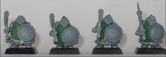

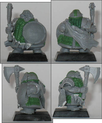

I have already started working, and it’s time consuming but exciting. I have removed the excess plastic from all 9 Warriors, this includes the arms, the shield icon, the beard, and the face. This was fairly easy to do with just an exacto knife.

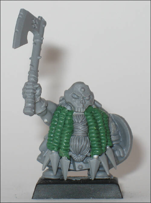

Next I added the beards by rolling thin green stuff and adding the detail. Then I glued on the skull mask using the bit from the chaos mutations sprue (the one with the spiky hammer fist).
I then took marauder right arms (the ones with no hands) and glued them on as well as the small marauder shoulder pad.
As I add to it, this thread will become a conversion guide for BFSP Dwarfs into Chaos Dwarfs.
Additionally, I welcome any ideas for converting BFSP models into other Chaos Dwarf units.

Xander:
I actually took off that Bull Skull and replaced it with a Plastic bit modified to look like a Bull Skull. It was tipping too easily before… and making me mad. :stuck_out_tongue:
I have just primed this unit today, and will be painting as much of it as I can tomorrow. So stay tuned!

Xander:
I essentially follow what this guy has done. The key factor is a “mold release agent” which is a fancy way of saying “something that makes sure the fresh GS doesn’t stick to the mold and become impossible to remove.” I either use a water-based lubricant or just a tad of water with wire handles so I can rip out the gs once hardened. :slight_smile:
