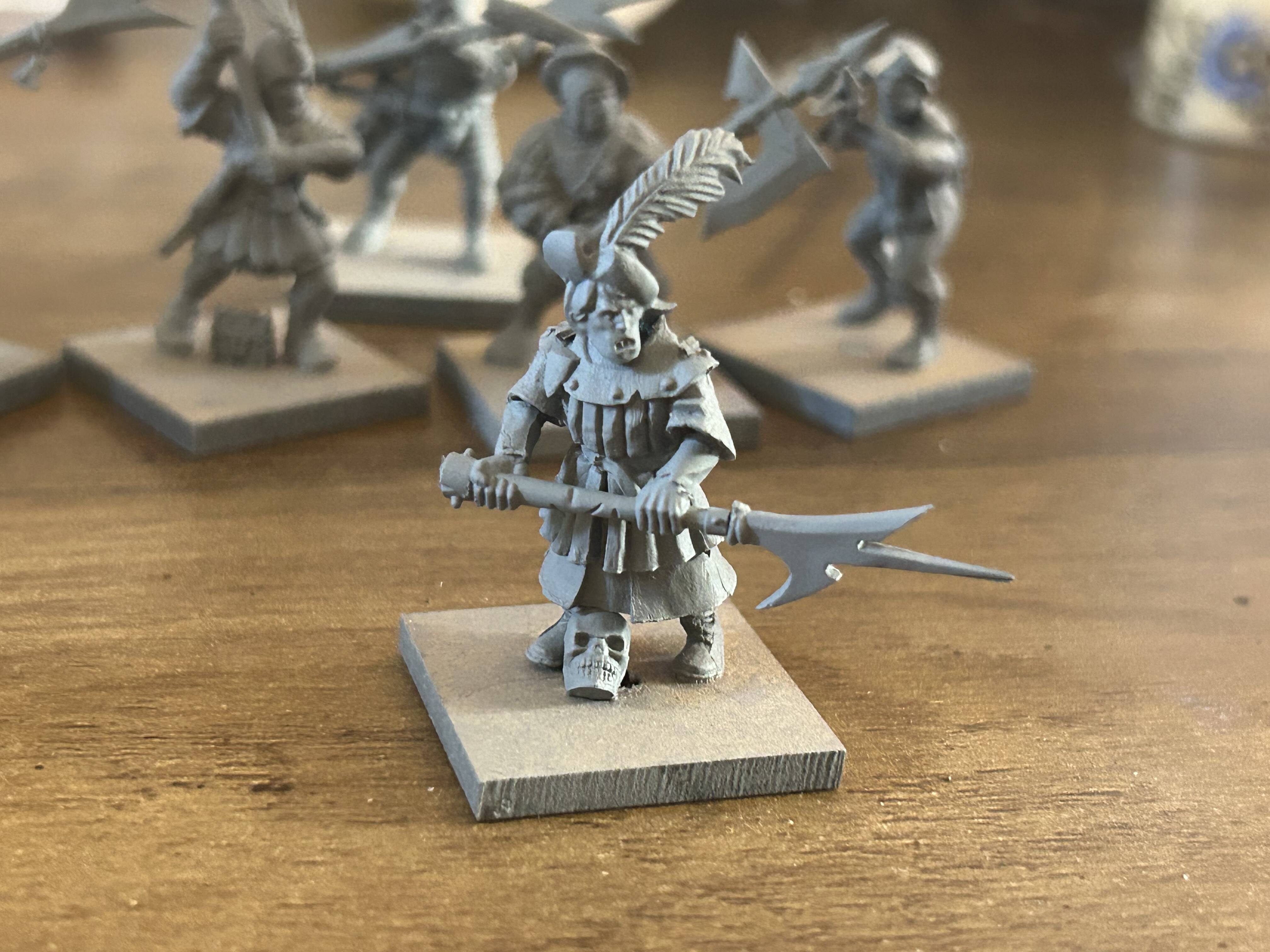

We begin with the model undercoated grey and then we dry brush white. I actually almost over brush the metal parts as helps in the next step.

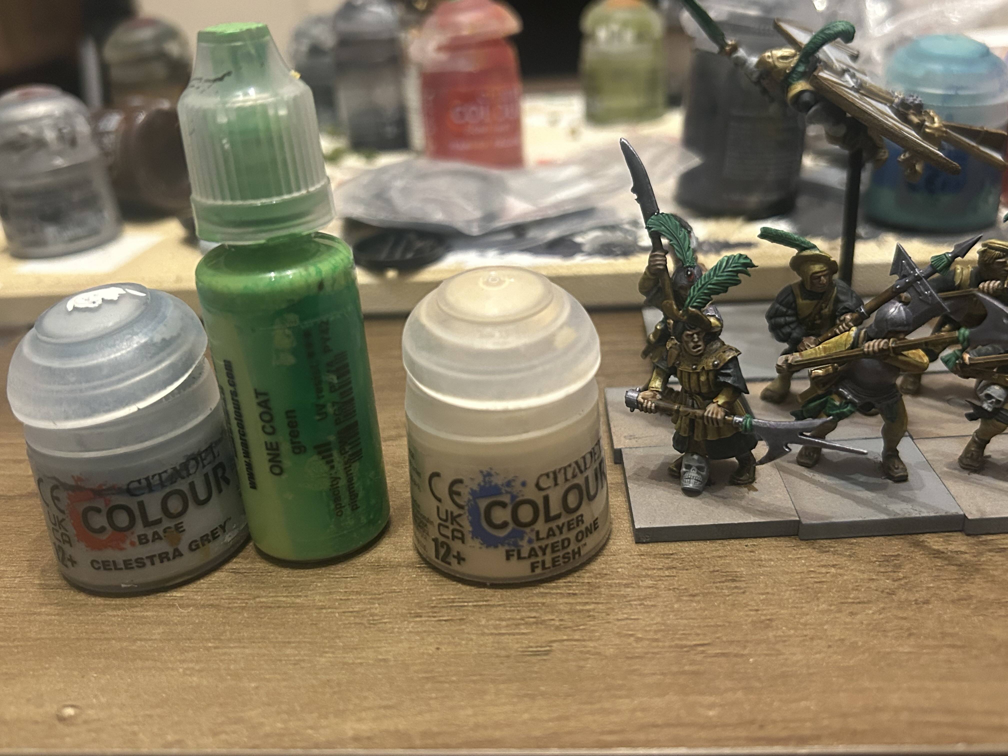

Then we move onto the contrast paints. Try to keep a limited palette to keep life simple. Here is what I used:
And here is each coat going on
I start with weakest pigment paint and work up to strongest pigment. So here, started with flesh and ended on black.

I now use highlights to help areas pop. My big cheat is that I use only three colours here. The green and grey highlight the green and black respectively. But the off white highlights the skin, the browns and the yellows. Makes for a much speedier paint job.
Here are the highlights going on:

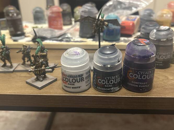

Next up I use washes in some of the recesses and over the metals for extra shading. Here are the two ubiquitous washes themselves nuln oil and aggrax. The nuln oil is used on black sections and the aggrax elsewhere. The metals get a full coating.

Eyes
My eye technique has not changed since I showed how it was done in my goblin streaking grime tutorial. White strip. Black dot. Purple wash underneath.
This step is SO optional. Basically nobody else will ever notice it. But I like it. I feel it makes the mini “come alive”

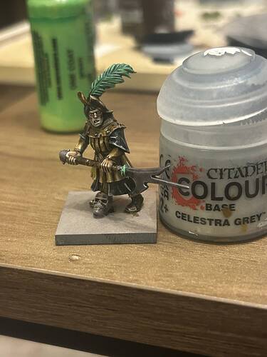

Stubble
Want to add some variety between some repeated heads? I have a 5 o’clock shadow using Celestra grey watered down and dabbed on around the chin and cheeks.
You can achieve something like a short cropped beard by using a darker grey.
