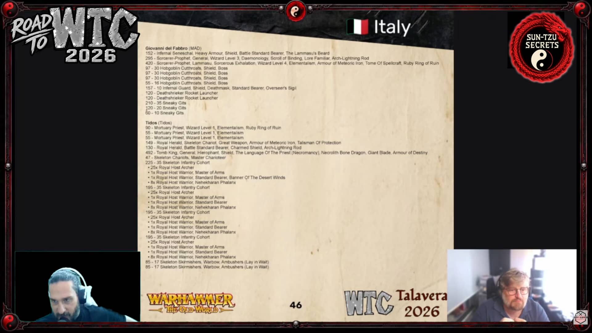

Still Italian CD list was very interesting. With several hobgoblin units and 70 sneaky gits. One unit of 35!
70 sneaky gits :hobkhan:
I guess it gives you amazing harrass potential !
Do you have the complete list at hand ?
Interesting no irondeamon… In playing 1x10 sneaky gits whole year, And they are pretty good. and will have 2x10 for nexts tournaments, but 35 in one unit? What a hell :rofl::rofl::rofl:
I foresee masses of players whipping multitudes of the indomible gits into massive lots, only to realize that now that the Italian list is out, 6 counters for every army have been made to render it obsolete. :smiley:

I was a bit disappointed that they didn’t talk much about this list in that video. It would have been interesting to hear how it’s played because I’m clueless.
I use 13-15 with boss and musician myself.
I honestly wish I could have seen at least one game with that list in action. Because I don’t get how it works. To me cheap units just die in droves. So what is he doing that makes the list win?
70 / 40 / 20 ranged attacks… That doesn’t suck. Just sayin’. Tarpits are great too when you have taurus and lammasu. Speed is better than dwarfs and point cost is negliable compared to Chorfs. I think people would underestimate this too, because it is greenskins. Just my best guesses on why this worked. I didn’t see the match.

I dont think so that all 35 , Will be full able to shooting do i still stand for concept 10 gits 60 pts and play 1-2-3 groups :wink:
