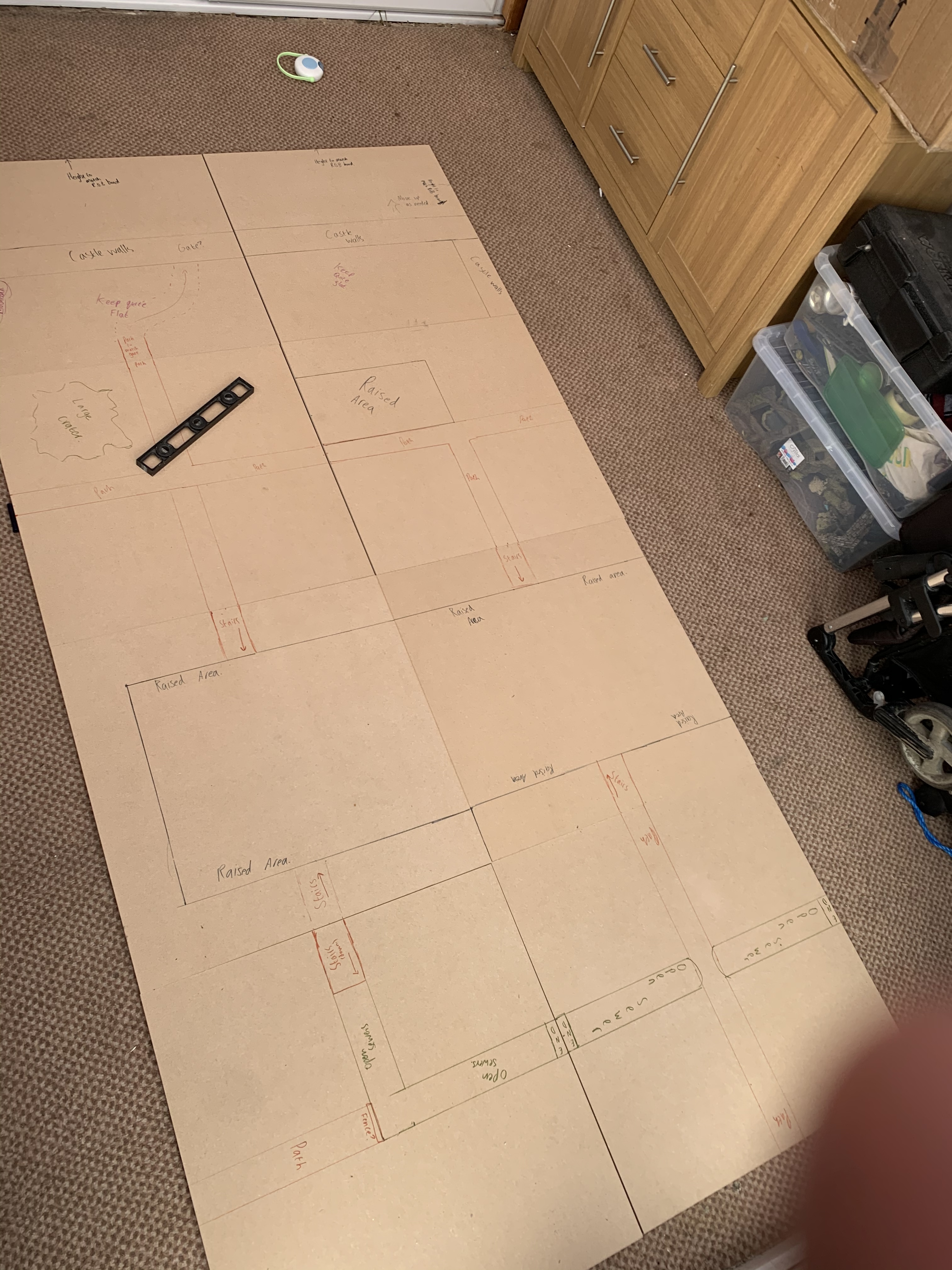

I’m going to be making a set of 6 tiles that can be arranged to make various 4x4 and 6x4 Mordheim set ups. Two of the tiles will incorporate my warhammer mighty fortress kit, which I’ve needed an excuse to use for something properly for some time, so that games can be played at the edge of the city.
Now here’s where my big plan comes in. I’m being gifted an AOS realm of battle board by a mate very soon. The two tiles which end with castle walls will be built up to the same height as a realm of battle board so that they can be placed next to those boards and serve as a castle wall in a warhammer siege scenario.
My idea is to have the 6 realm of battle tiles and the 6 home made tiles and be able to make a battlefield, a multi level skirmish board and a siege board using them.
Another aim of this mordheim board is to try to keep it as setting agnostic as possible. I will avoid having anything overtly fantasy themed stuck to those 4 tiles. ( the castle ones can have a bit more of that). That way by changing the scenery upon it, I can make a 40k city board or a necromunda board as well. When it comes to my next nexromunda campaign I could maybe add a couple of tiles with some tech stuff that match these tiles to help sell this. So I’m trying to go for an aesthetic that could be carved rock or concrete depending on the setting.
Again trying to maximise the use of these boards.
Here are the first 6 tiles with designs sketched out:

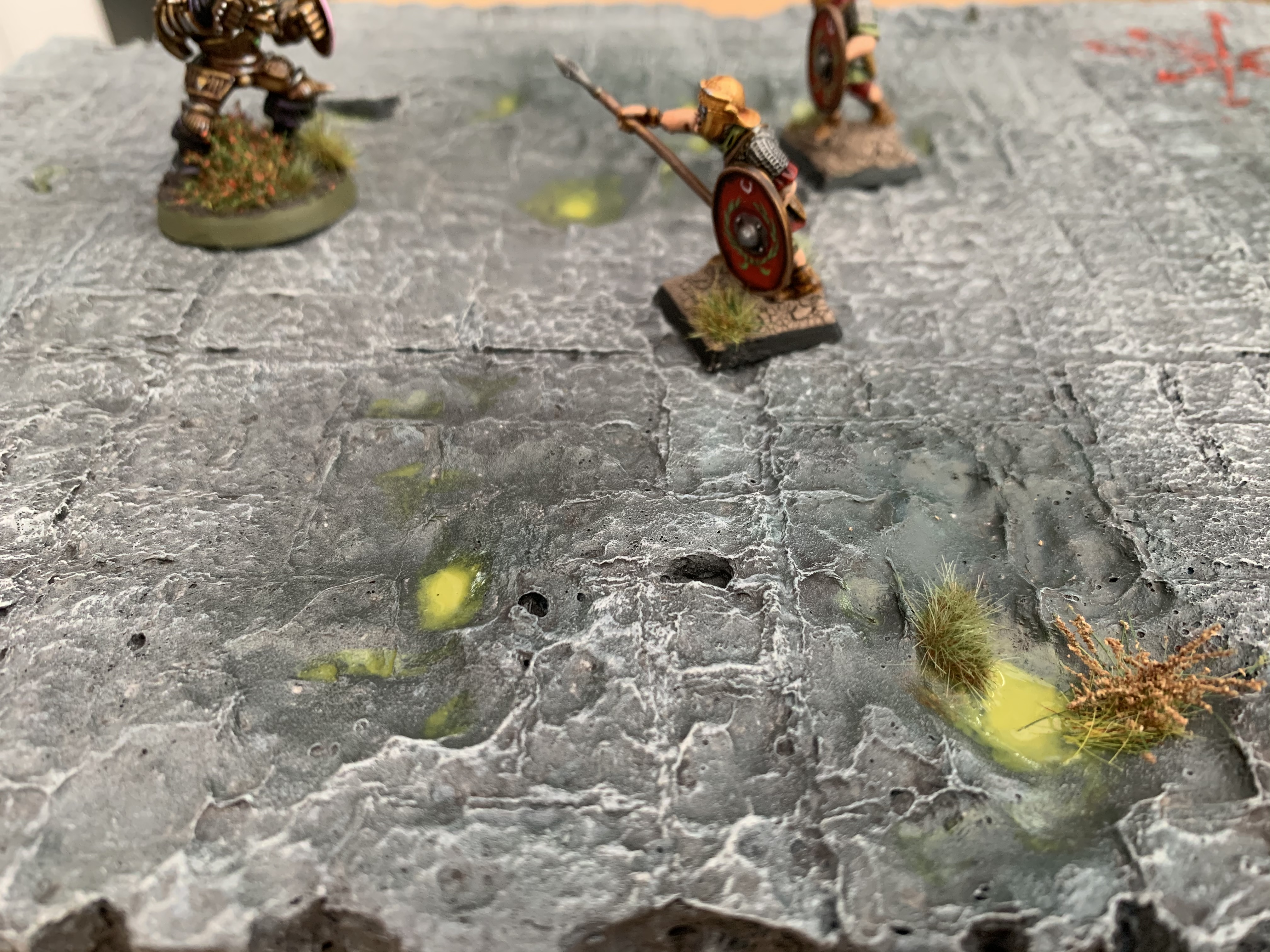

Now I’ve done a paint test piece using the foam I’m planning on using the board. My dad printed me some brickwork and tile stampers to add a texture to these things.
I protected the foam from spray paint using PVA but unfortunately didn’t protect it well enough. So parts melted. It’s only a paint test so I decided to roll with it and make some infected nurgly looking puddles in the melted places.
Great stuff. The enterprise you have amazes me. But even more crazy- we have the same carpet hahaha
Easily amused i guess…
Sounds great! Looking forward to see the boards… :slight_smile:
And dont spray foam, even it sealed with PVA etc it doesn’t work 100% IMO. Always better to take the extra time and brush it on considering you’ve probable spent 5 times as long converting and cutting the foam. :wink:
Advice appreciated :+1:t2:
Nice start. The melted bits don’t even need to be Nurglish bits to be honest; they could easily just be damaged part of the road which the local council haven’t bothered/gotten around to fixing and thus degraded over time. More so considering there isn’t anyone to fix things after the comet fell anyway. :wink:
Also, you don’t even really need to add anything to use it for 40k, remember within the Imperium there are feudal worlds which are worlds on the tech level of the Empire so it’s serviceable either way. ;). So long as there’s nothing Elven around it should work; dwarf stuff is just a local population of squats, Skaven stuff is from underground mutants, etc.

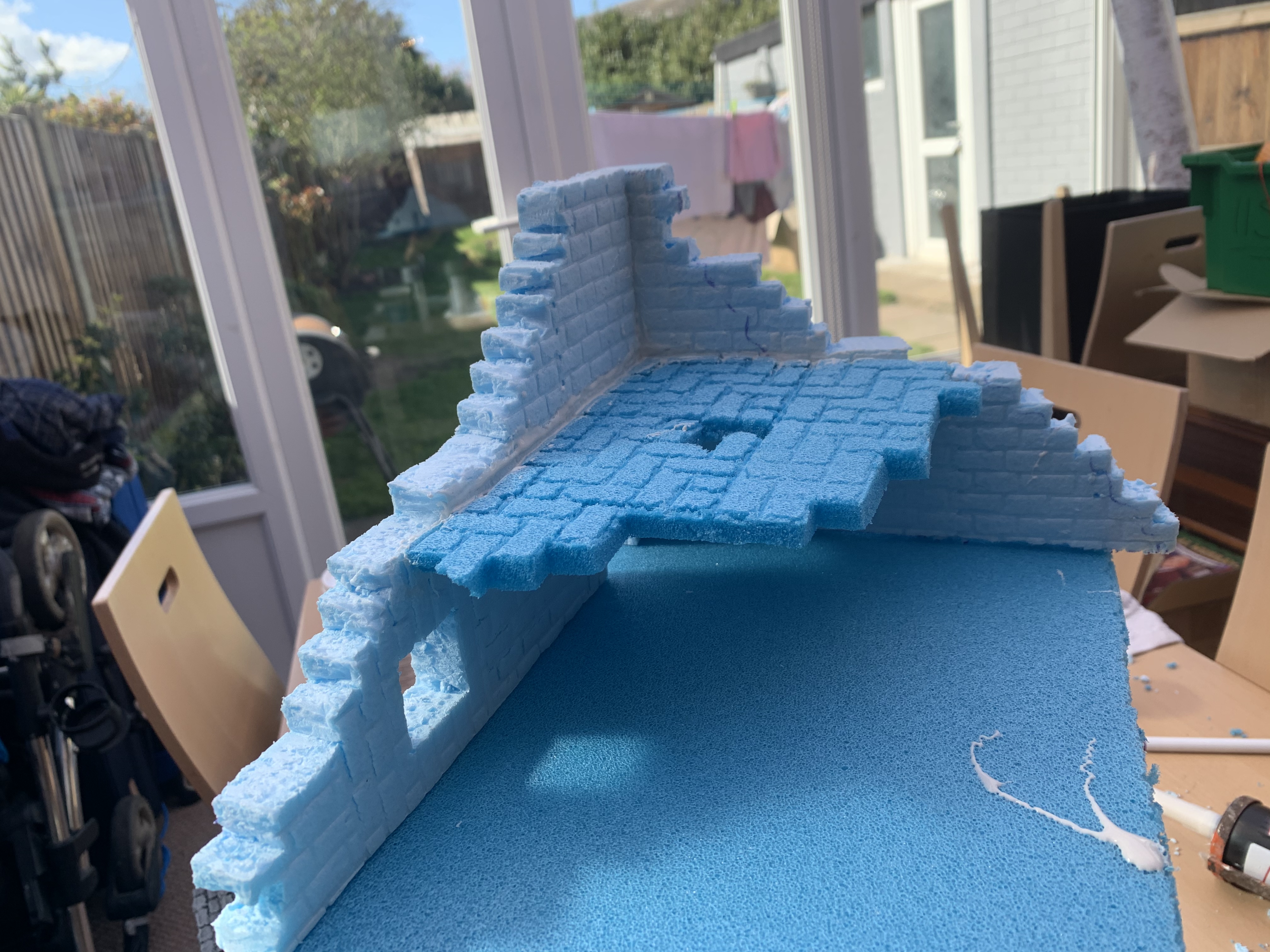

First test build for the ruins that will be attached to the board. The boards will have 50% ruins attached and 50% space for adding extras. My hope is that something simple and robust looking like this will be medieval if I stick the right scatter around and Tudor ruins nearby but will be the underhive if I stick big rusty machinery nearby
Trying to keep the buildings as generic as possible so as to fit both settings when needed

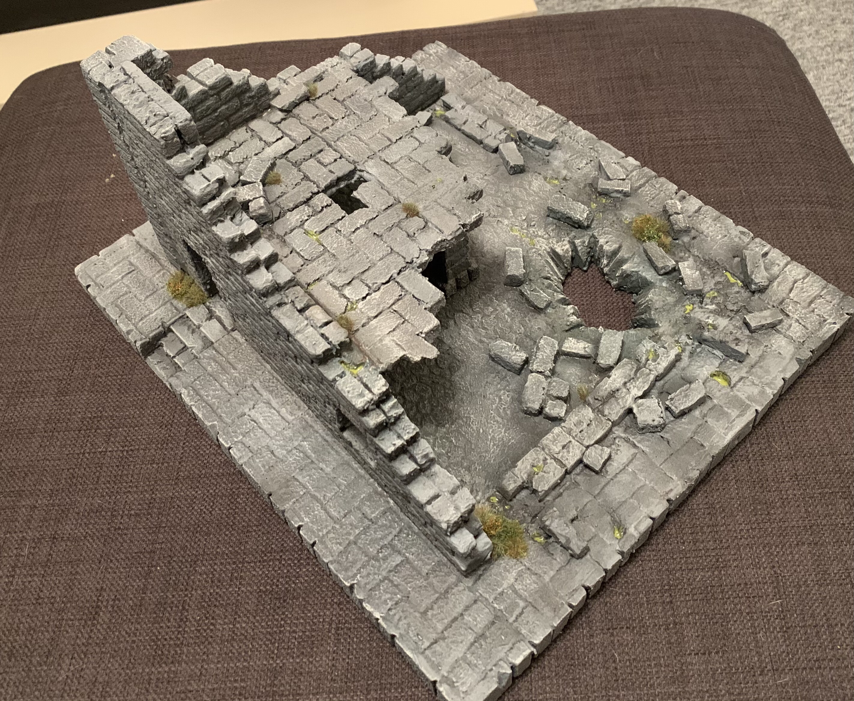

Second test piece. No melting this time! (Brushed on primer mixed with filler and glue.which also have the bricks a nice texture too)
as we said today on discord, looking really nice, especially after the pillars were added!

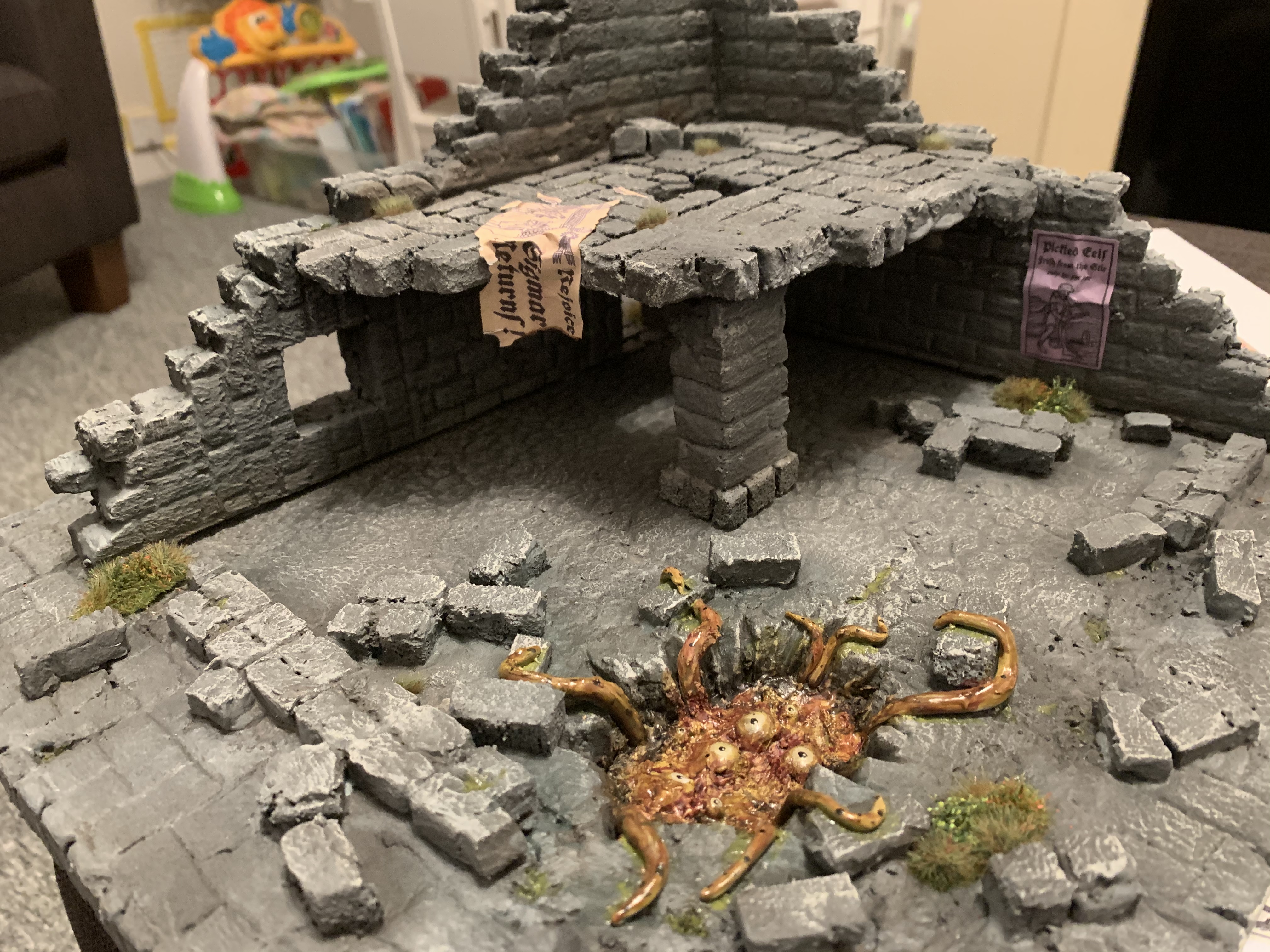

Added a bit of chaos!
you just added the essence of that kid who gets too close and asks if you have games on your cellphone :chaos2:
Haha brilliant Eddy :joy:
Trying out posters now to create a bit of variety
remember to age them, that place is crumbling, noone civilized probably has been there in months/years.
some black crap will start to leak/ooze from the walls staining the parchment, or whatever that material would be!
nowdays i’m all into leaking stuff and rusty effects with corrosion around, works for fantasy too!
if i can give you another suggestion, try to pile up some dust/earth/dirt close to the walls edges and that pillar, there is where stuff will collect automatically due to weather and wind.

The posters looks great! When Ive done posters for WWII related stuff before I soaked them in a mix of 1/4 PVA 3/4 water. Then stay more flat to the surface, could be nice to add some weathering as well using GW Shades or similar? :slight_smile:
