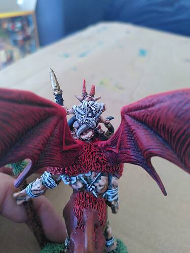

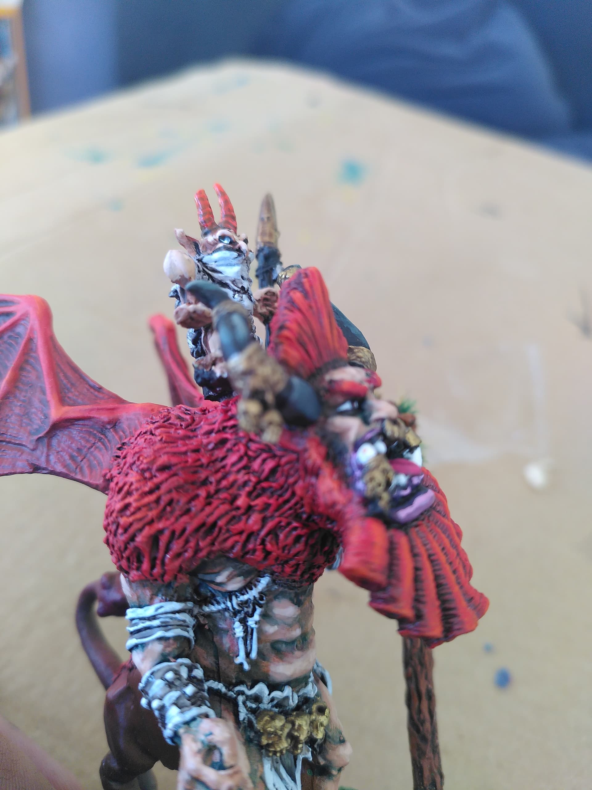

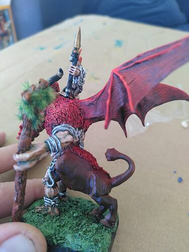

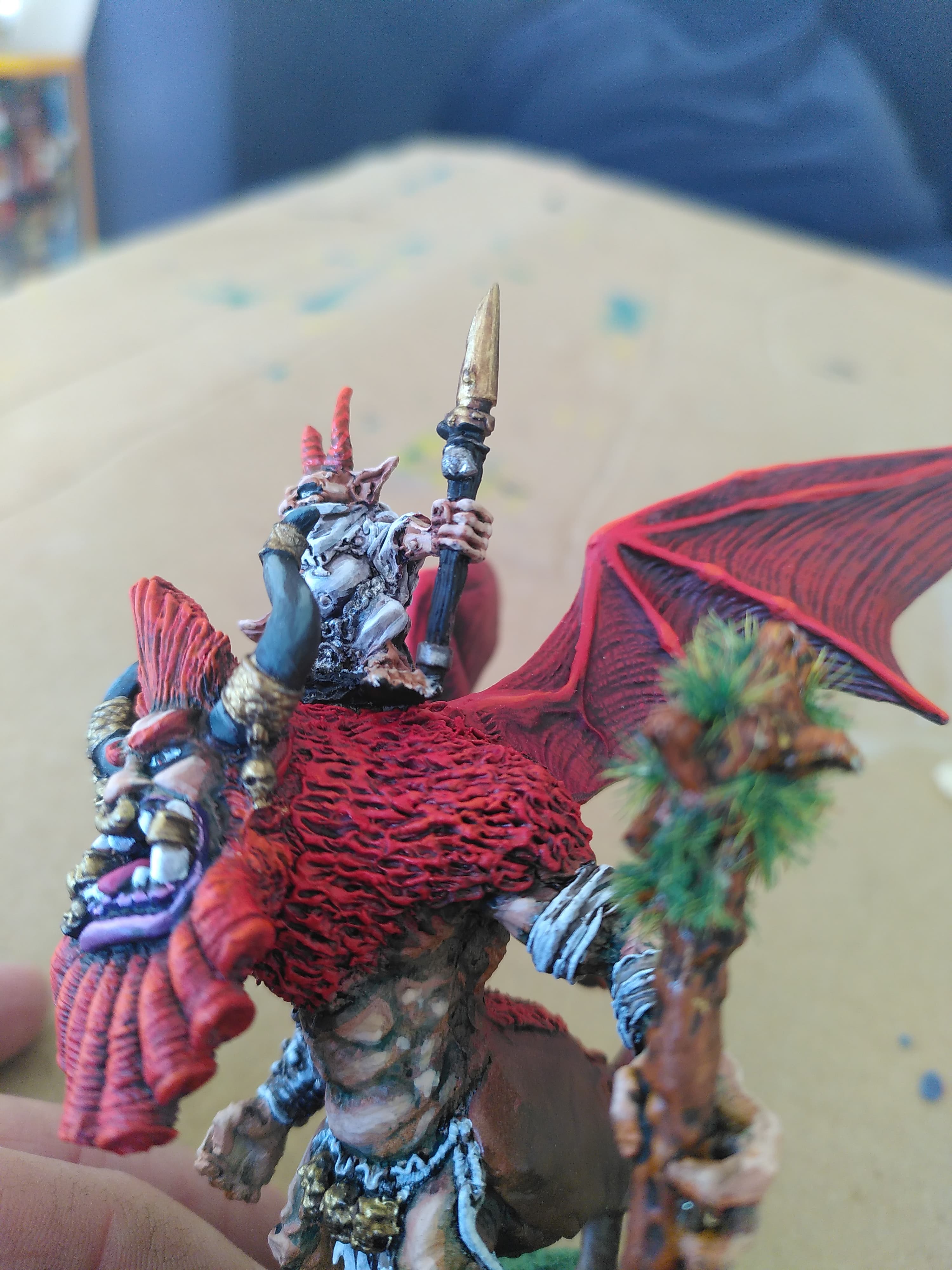

I sculped fur with greenstuff to cover up the joins where the head meets the body

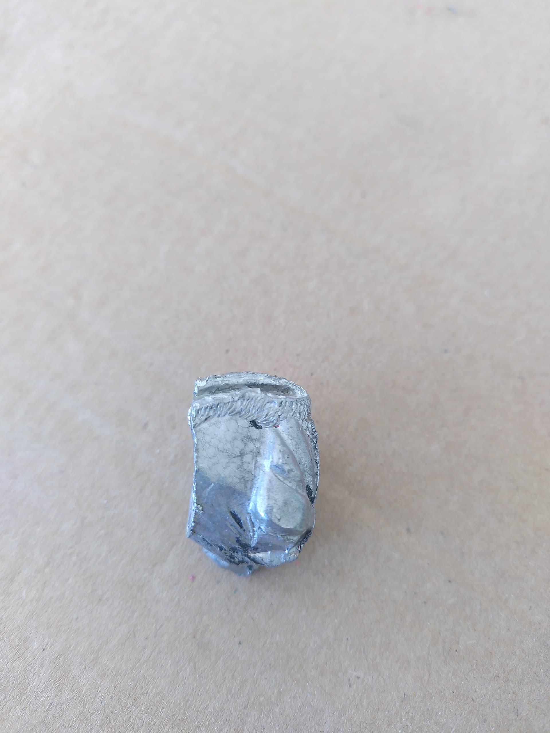

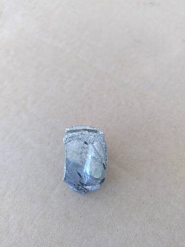

I chopped the back legs off the bull part of the Lamassu and stuck him to the waist of the Ettin - was left over with a chunk of metal. Then using green stuff covered the gaps with more fur and did some rough sculpting of bull flanks where they joined the ettins body.
Brilliant! Yeah fur is a godsend for joins aint it

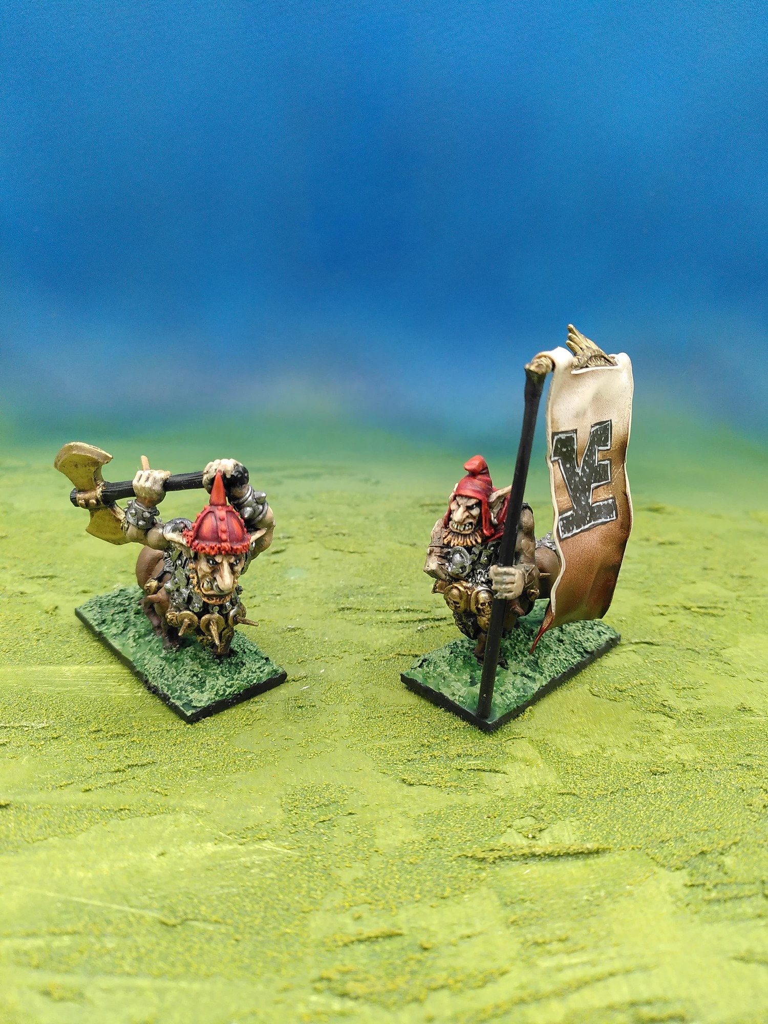

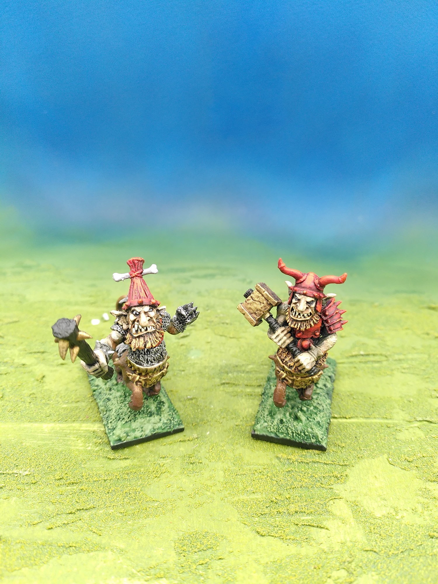

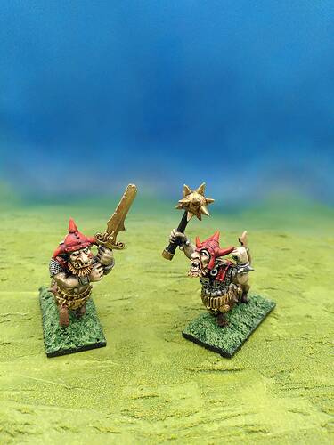

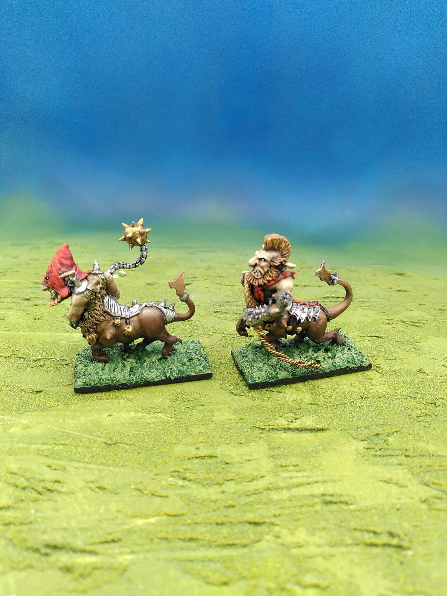

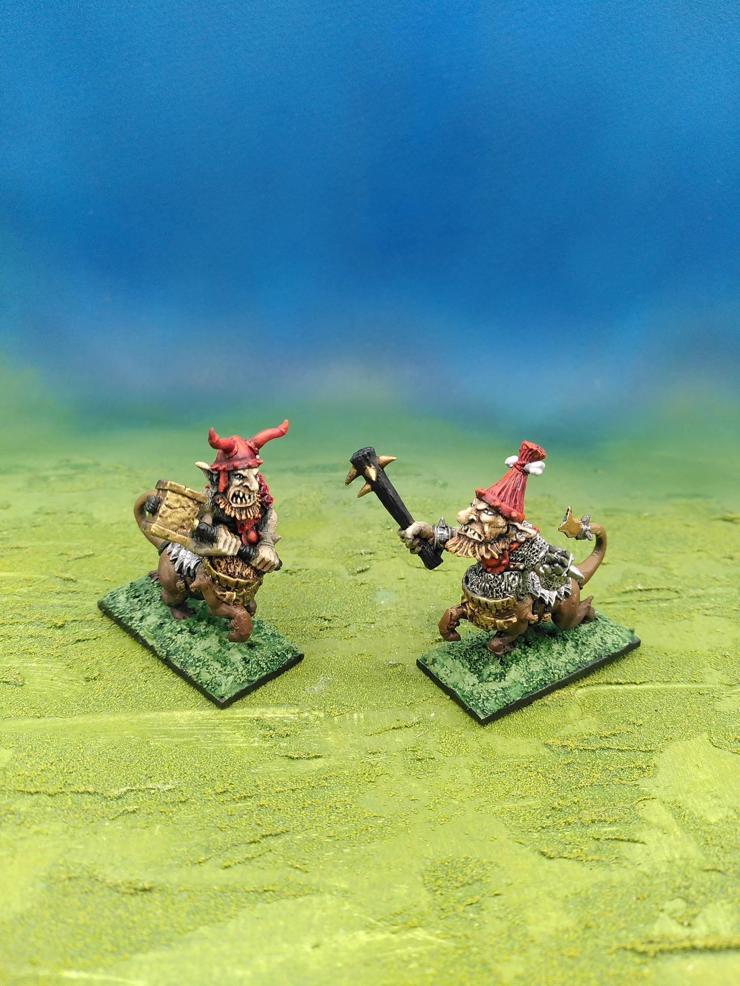

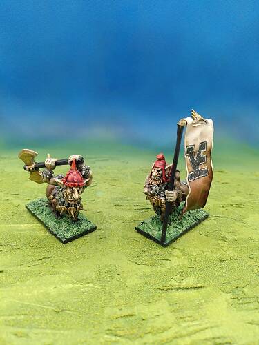

Bull Centaurs incoming

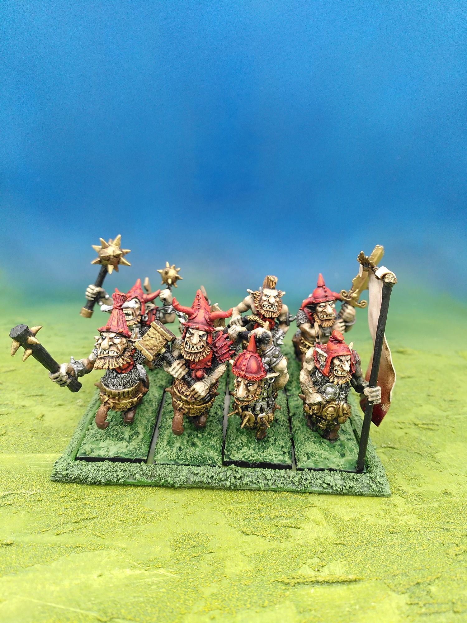

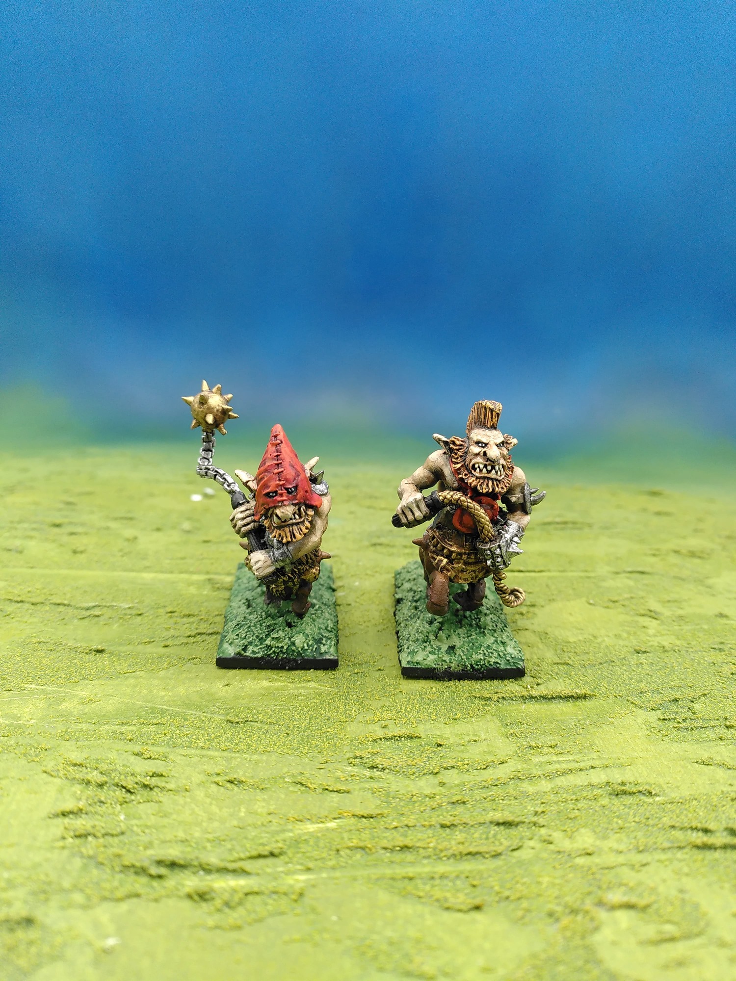

For these models i used mantic bull centaur bodies combined with knightmare miniatures bugbears
https://www.manticgames.com/games/kings-of-war/abyssal-dwarf/abyssal-dwarf-halfbreeds-regiment/
https://knightmareminiatures.com/product/bugbears-regimiento
As the bugbears were metal it was a bit of a pain and a fair bit of green stuff armour was needed where model joins the bull. Luckily I had a mega sharp jewelry making hacksaw so cut through metal very easy.
For the painting I did all the skin in oil paints and am happy with the tone…I think oil painting of skin works well as you need all the different layers that adds to the flesh tone.
These were the most converted unit in my army …when I saw the costs of bull centaur big hats plus the hats wouldn’t have really have matched. So had to find something else. I spent ages trying to find a bull centaur body (oldhammer searching didn’t bring up any suitable OOP models) . In the end went with the mantic bulls and they worked well. They are a fair bit smaller than the bugbears but think the smaller body / bigger torso makes them look cooler as focusing on the awesome knightmare miniature heads /faces
I feel pretty confident in saying this is an original idea and noone has ever done this before. Lovely unit, great job. Good centaurs for 3rd edition is probably the biggest problem. I like the slightly comical nature of their faces.
Thanks very much. Yeah not many options out there at all. All horse type creatures from oldhammer GW don’t really work and things like centaurs are like hens teeth rare

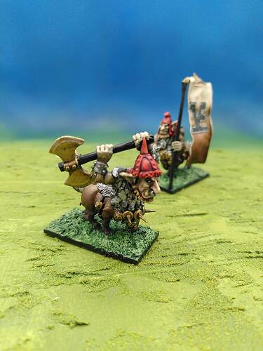

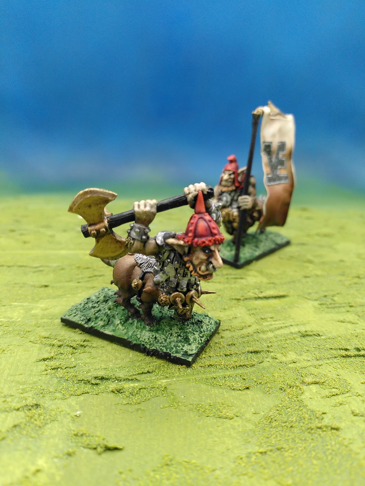

The upper bodies are from Metal Magic models (was a German company, went out of business in the mid 90’s) and the bodies are from Citadel (the 3rd edition Boar Centaur bodies).
I used the models for WHF (although my last game was years ago) as BCs - it is a 75 x 50 mm base. Since one model looked a bit lost on the large base, I just positioned 2 models on it.
